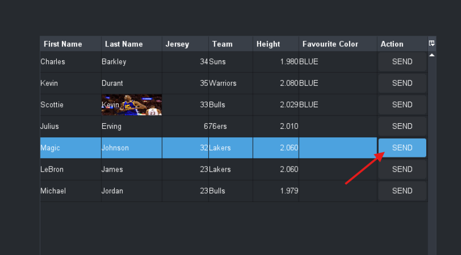

    Hello !
    I was fiddeling around with STRUCTs and STRUCT_ARRAYs for a table. I was able to setup a dropdown widget to show up in one column for each row. Also a toggle/checkbox was achievable. That's pretty neat and will definitely come in handy for a lot of things.
    However I was wondering If it is possible to show a non-data related component in a cell but instead render a button for example that triggers an action/task ? My Goal was to have this button for each row in the last column.

    Thanks for your suggestion James ! I believe this is what I come up with in the end, to use a subparam with constrainttype INT_CHOICE. However I am having difficulties to find the right widget for it. So far only widget="button" seems to give me an actual button, instead of a dropdown. I tried a few other wordings for push button or toggle button but no luck. Couldn't find a list of available "widget" values.

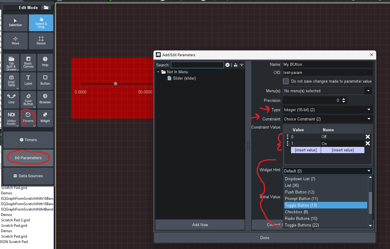

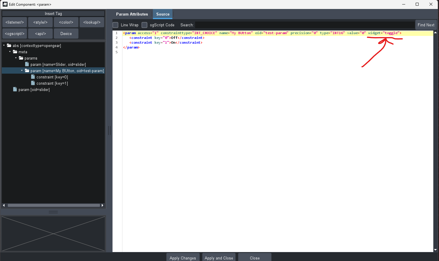

    You can get a good list of most widget hints available in the param edtior UI.  They are largely the same for structs as they are for regular parameters:
    Once you create a basic parameter you can go to the source view to see the string used for that widget hint
