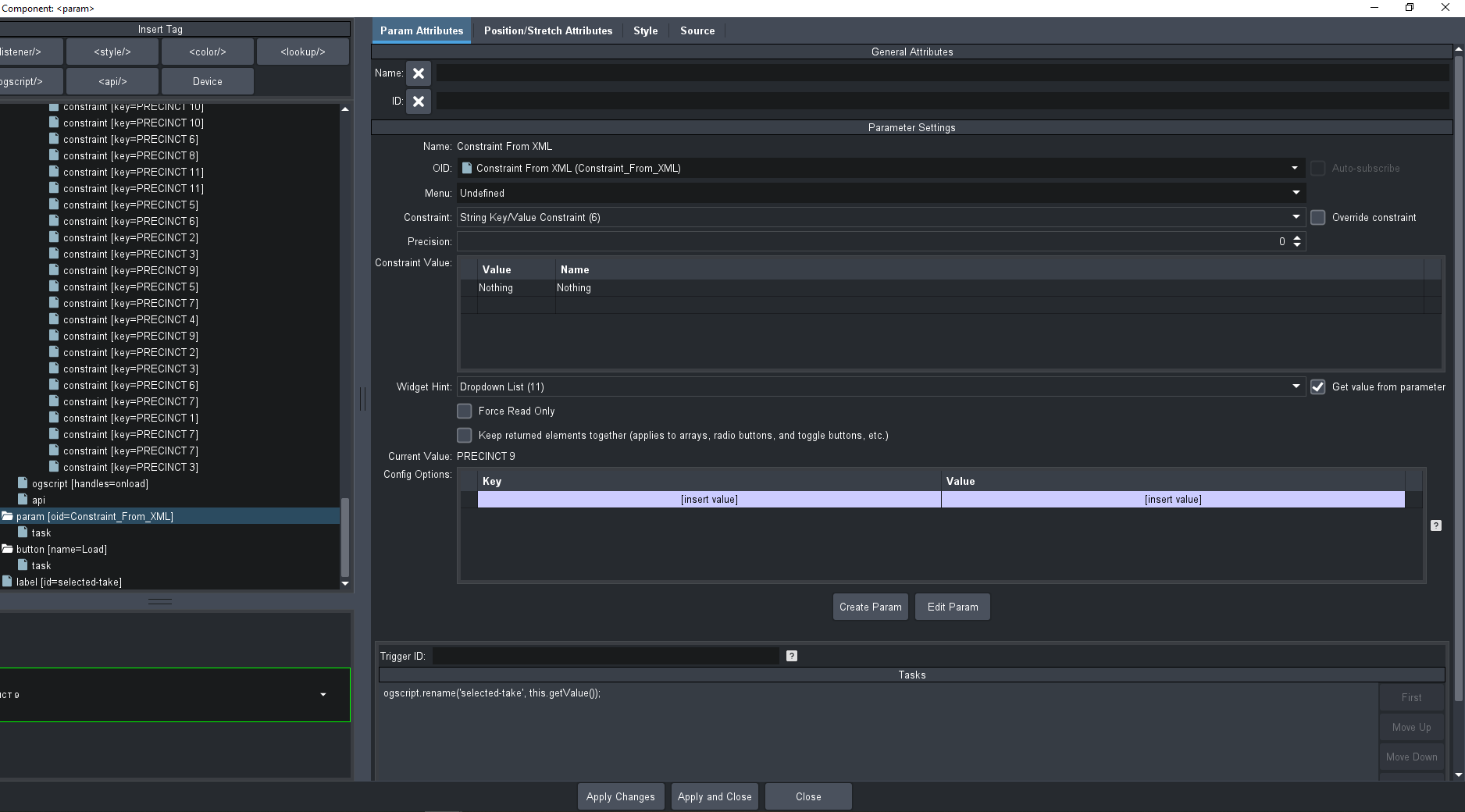

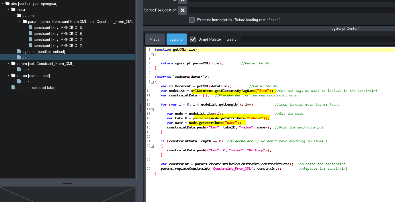

    Hi James,
    Thank you for the information, I have tried to modify the parameters based on your suggestions however I am still having the issue where the key value pairs are not appearing in the parameter attributes section.
    I have attached a copy of the new code as well as a picture of what I am describing. I am unsure whether its an issue with reading in the file or if there is something else I am missing. I know that you had mentioned that you created some sudo data for testing the functions, however after removing that it seems like the files are not being detected.

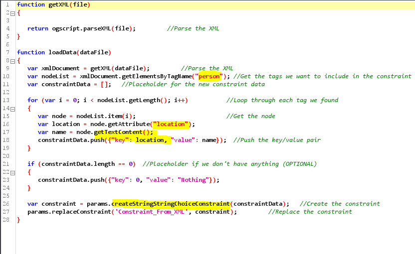

    Hi Tejus
    I'm a little confused by your source XML file.  The ogScript in the Custom Panel is looking for <item/> tags with attributes called "takeid" and "name" inside of the root document (see picture) but you appear to be embedding an <abs/>, <param/>, and <constraint/> tag.  The XML file is whatever you want it to be but this appears to be an odd collection of tags to use for your data.
    The changes I had suggested for your file would look like this:

    These are the changed areas to match the new file with the Custom Panel:
    James Peltzer

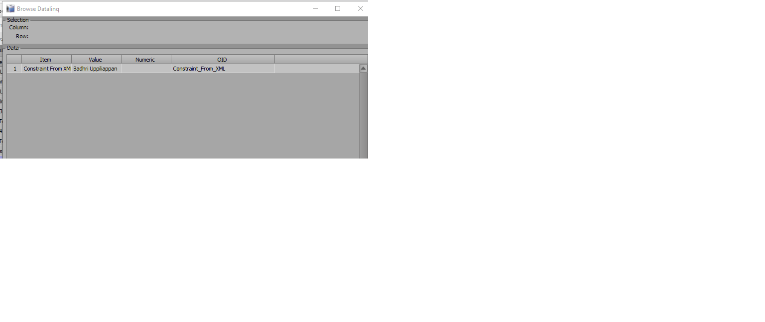

    I had a couple questions regarding connecting datalinq to DashBoard. Based on the code you had provided last week  I was able to get the xml working. However when I try to load the information from DashBoard to Datalinq I am having 2 issues.
    1. Sometimes when I type a person's name in and press load it appears that the name resets to something else than what I typed.
    2. After loading a name and value from dashboard when I check the datalinq side, it appears that only the name is loaded and not the appropriate Precinct accompanied. I have attached a screenshot describing the second issue I am facing below.
    Thank you for your help!
    Tejus

    Hi Tejus
    You can expose as many parameters to DataLinq as you like. If you want to write additional details to DataLinq, you would create additional parameters and set their values whenever the selection in the dropdown list is changed.
    You might want to look the example where I change the selection in the table based on whatever was searched for in the text field.
    James Peltzer

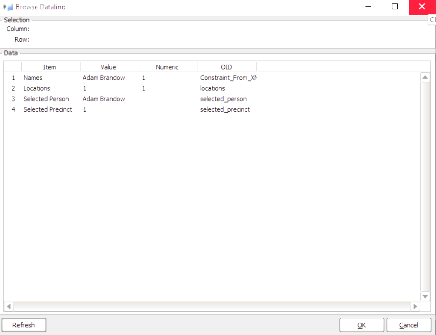

    Hi James,
    Thank you for your response.
    I have tried to modify my xml file based on your xml version 2 you had posted above from a while ago. However I am still having  issues separating the name and precinct into 2 separate columns in datalinq. Specifically when I add a new parameter to my existing file.
    I have placed a version of my currently working xml file below, please let me know if you have any recommendations on how to split the precinct and names into 2 columns.
    Thank you
    Tejus

    Hi  Tejus
    While you could use a struct to add additional parameter information,  I don't know if your use case is complex enough to warrant it.  You can just create 2 new parameters to hold the 2 parts of the parameter (the selected value and the selected display name).  You can then simply write to these parameters whenever they change and use THOSE for DataLinq.
       <meta>

          <api>function getXML(file)
       return ogscript.parseXML(file);         //Parse the XML
    function loadData(dataFile)
       var xmlDocument = getXML(dataFile);         //Parse the XML
       var nodeList = xmlDocument.getElementsByTagName("person"); //Get the tags we want to include in the constraint
       var constraintData = [];   //Placeholder for the new constraint data
       for (var i = 0; i &lt; nodeList.getLength(); i++)           //Loop through each tag we found
          var node = nodeList.item(i);                          //Get the node
          var location = node.getAttribute("location");
          var name = node.getTextContent();
          constraintData.push({"key": location, "value": name});  //Push the key/value pair
       if (constraintData.length == 0)  //Placeholder if we don't have anything (OPTIONAL)
          constraintData.push({"key": 0, "value": "Nothing"});
       var constraint = params.createStringStringChoiceConstraint(constraintData);   //Create the constraint
       params.replaceConstraint('Constraint_From_XML', constraint);         //Replace the constraint
    }</api>

    This version uses 2 parameters with INT_CHOICE constraints. The only one we show on screen is the one for searching the names - whenever its value changes, we set the location one to the same value to keep it in sync.
       <meta>
          <params>
             <param access="1" constrainttype="INT_CHOICE" name="Names" oid="Constraint_From_XML" precision="0" type="INT32" value="0" widget="combo">
                <constraint key="0">Aaron Cunningham</constraint>
                <constraint key="1">Adam Brandow</constraint>
                <constraint key="2">Adam McCusker</constraint>
                <constraint key="3">Albert Glenn Diggs</constraint>
             </param>
             <param access="1" constrainttype="INT_CHOICE" name="Locations" oid="locations" precision="0" type="INT32" value="0" widget="combo">
                <constraint key="0">PRECINCT 9</constraint>
                <constraint key="1">PRECINCT 6</constraint>
                <constraint key="2">PRECINCT 2</constraint>
                <constraint key="3">PRECINCT 2</constraint>
             </param>
             <param access="1" maxlength="0" name="Selected Precinct" oid="selected_precinct" type="STRING" value="PRECINCT 9" widget="label"/>
             <param access="1" maxlength="0" name="Selected Person" oid="selected_person" type="STRING" value="Aaron Cunningham" widget="label"/>
          </params>
          <ogscript handles="onload">var newConstraint = params.createIntChoiceConstraint(["Nothing"]);
    params.replaceConstraint('Constraint_From_XML', newConstraint);
    params.replaceConstraint('locations', newConstraint);</ogscript>
       var locationData = [];   //Placeholder for the location data
          locationData.push(location);
          constraintData.push(name);  //Push the key/value pair
          constraintData.push("Nothing");
       var constraint = params.createIntChoiceConstraint(constraintData);   //Create the constraint
       constraint = params.createIntChoiceConstraint(locationData);   //Create the constraint
       params.replaceConstraint('locations', constraint);         //Replace the constraint
    }</api>
       </meta>
       <param expand="true" height="90" left="32" oid="Constraint_From_XML" top="48" width="626">
          <task tasktype="ogscript">params.setValue('locations', 0, this.getValue());
    params.setValue('selected_precinct', 0, params.getParam('locations', 0).getValueAsString());
    params.setValue('selected_person', 0, this.getValueAsString());
    ogscript.rename('selected-take', this.getValue());
    </task>
       </param>
       <button buttontype="push" height="95" left="673" name="Load" top="47" width="183">
          <task tasktype="ogscript">loadData('constraint-xml-tester.xml');</task>
       </button>
       <label height="142" id="selected-take" left="34" style="txt-align:center" top="164" width="815"/>
       <param expand="true" height="53" left="83" oid="selected_precinct" showlabel="false" top="332" width="353"/>
       <param expand="true" height="55" left="454" oid="selected_person" showlabel="false" top="330" width="340"/>
    James Peltzer
