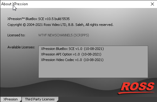

    Make sure your BlueBox has the Datalinq license. BlueBox App > Help > About > Licenses
    Looking at your account assets in the Ross customer asset list, I don't think you have the Datalinq License for XPression BlueBox. It looks like you just have BlueBox SCE (Single Channel Edition) and XPression Developer and Tick-it Core.

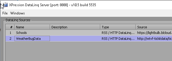

    BlueBox and the DataLinq Server are running on the same machine.
    I changed the server address in the project to localhost/127.0.0.1 but that made no difference.
    I find it very suspect that we were sold something with components that don't talk to each other.
    To my knowledge, we were sold a license for:
    A BlueBox playback server
    A DataLinq Server
    A license for Developer
    The DataLinq server pulls data as expected but is only allowing the connection from the developer machine.

    You do not have a Datalinq license for your XPression BlueBox. The Datalinq Server software is not licensed, BlueBox must be licensed to connect to a Datalinq Server. XPression Developer does not require a Datalinq license to connect to the Datalinq Server (it is included).
