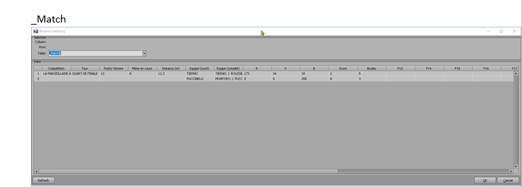

    I'm new to the world of Ross-Expression.. The question (the title) says it all.
    And I need to use Excel as my database.
    The links work, but I'd like to improve my workflow.
    • Is it possible to update DataLinq data in XPression without having to manually save (Ctrl+S) the Excel file?
    • Is it possible to dynamically update value fields directly on the On-Air video output, bypassing the Sequencer?
      (I checked the "update" box, but I'm still forced to go through my sequencer.)
      Thank you for your helpful answers.

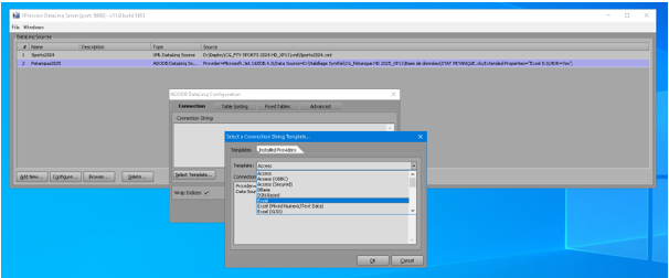

    It is not possible to update Datalinq in XPression without saving the excel file. Datalinq is reading the file saved to disk, rather than what's live in the open Excel workfbook.
    The new .xlsx file can be used, but on machines with 64-bit versions of Microsoft Office, you have to install the 32 bit Access Database Engine for Datalinq to read Excel file.
    https://support.rossvideo.com/hc/en-us/articles/5382092783771-XPression-Installing-Access-Database-Engine-ACE-with-64-bit-Microsoft-Office
    Multiple users can access the file as long as its set up to use Legacy Sharing in Excel
    https://www.rossvideo.com/blog/u_tutorials/80997/
    With these two configurations, the Datalinq Source set to refresh every second as you have, and the Live Update button checked in the Datalinq options on the text object in XPression, the scene should update on-air within a second of saving the new data in Excel.
