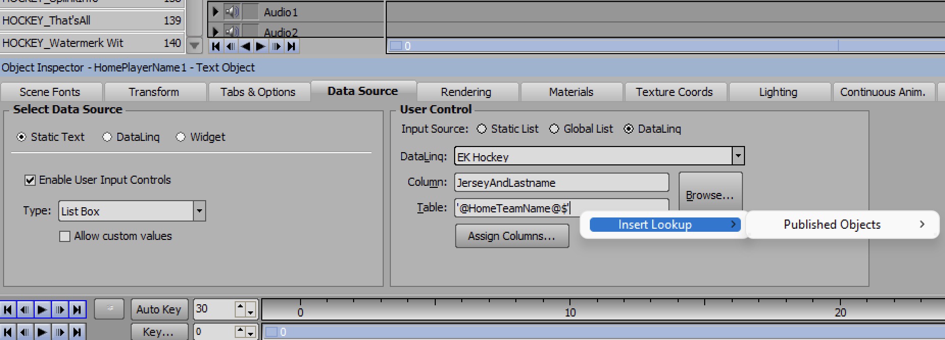

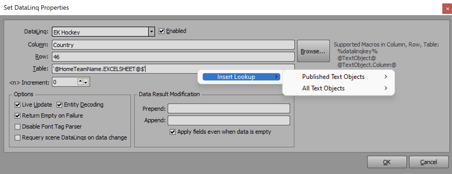

    I am able to insert a Lookup macro to the "normal" DataLinq option within XPression. And I choose to link between published items and not-published items. I can even choose a column in the requested item (as you can see on the "Table" line ('@HomeTeamName.EXCELSHEET@$') in photo 1).
    And now my problem: I don't have the same options when I want to access a DataLinq in the Static Text->User Control option :-(.
    Is this a known issue and is this going to be fixed in the near future?

    if you type the name of the object in does it still work or not?
