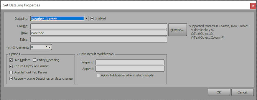

    I have a question about DataLinq requests from within XPression. We have a scene that gets DataLinq info from the server, hosted on the MOS Gateway machine. The data is a weather condition that links to Dynamic Materials that are AVI movies and icons. We've had an issue where the scene is put in a framebuffer and the the template defaults are used instead of new DataLinq info. In looking at the logs for the DataLinq server, for an take item that ran today around 15:03, I do not see a request from the Studio box for that take item, but later in the show I do see the request when the same scene was played.
    In the scene, the DataLinq properties are set to 'Return Empty on Failure' but the template defaults stay. I've looked around and I haven't found a place in Studio where outgoing DataLinq requests might be logged.

      |   view attached
    All of the materials are are just avi videos and their filename matches the data. So if the condition is '31' it plays 31.avi. I don't see any macros other than just the dynamic material under the DataLinq tab referencing the text object that is being driven by DataLinq. (image)

    You need to check requery on datalinq for the Weather Condition object.
  • 5.  RE: DataLinq Source Requests
    Posted 06-18-2026 19:20
    I checked all four objects that use DataLinq and all have that checked. Appreciate the help.
