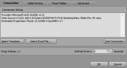

The Excel located at another PC C driver which had shared with everyone on the network. This following are the info of the connection and XP.
Excel : .xlsx
Excel Location: Remote Pc within the same network, same router, same switcher, ping is stable, no heavy network transfer in this network
Datalink Method: ADODB Datalinq Configuration
Refresh Every : 0
Xp ver : 11.5

The excel file that Datalinq Server connects to, is Datalinq connecting to a drive/network share?
A workaround you could use (not suggestion this as a solution) is if you are version 12.0, you can right click on a take item and convert Datalinq fields to static text. So you could capture the correct data in the take item, convert it to static, before you took it to air.
Might be use to see the setup config of your excel file in Datalinq as well.
