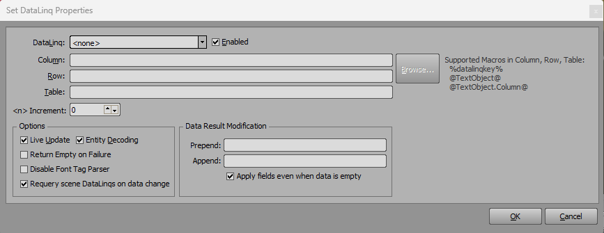

    On any @marcos@ that are connected to data you need to select this;
    bottom left of this window
  • 3.  RE: Datalinqs Seemingly Failing on Take
    Posted 06-11-2026 10:55
    Ahhhhhh, yeah that did it. Thank you so much, I could not for the life of me figure that out!
