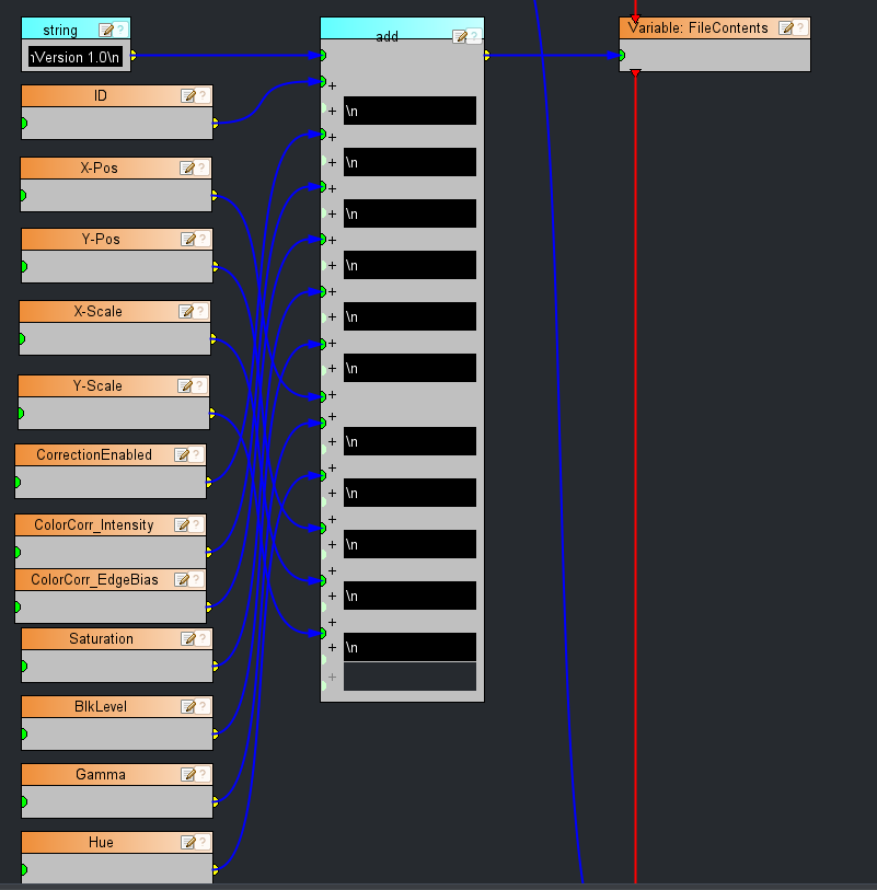

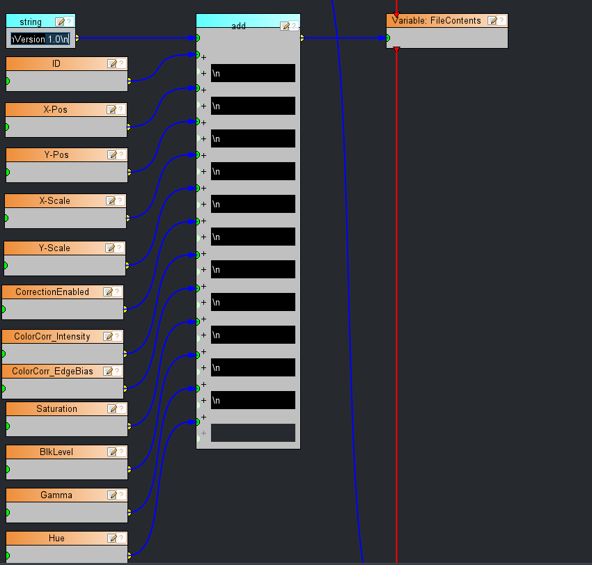

    Originally had this happening in Dashboard 9.15 but just upgraded to 9.16.1 and seeing this same behavior. When using a Visual Logic "add" block to concatenate several parameter values and line breaks to prepare to write to a file (which can be opened by this same CustomPanel later), When I save changes to the Visual Logic sheet and re-open it, the order of parameters get scrambled every time. Obviously the order that these are written to the file matters. See below screenshots. Is this a bug?
