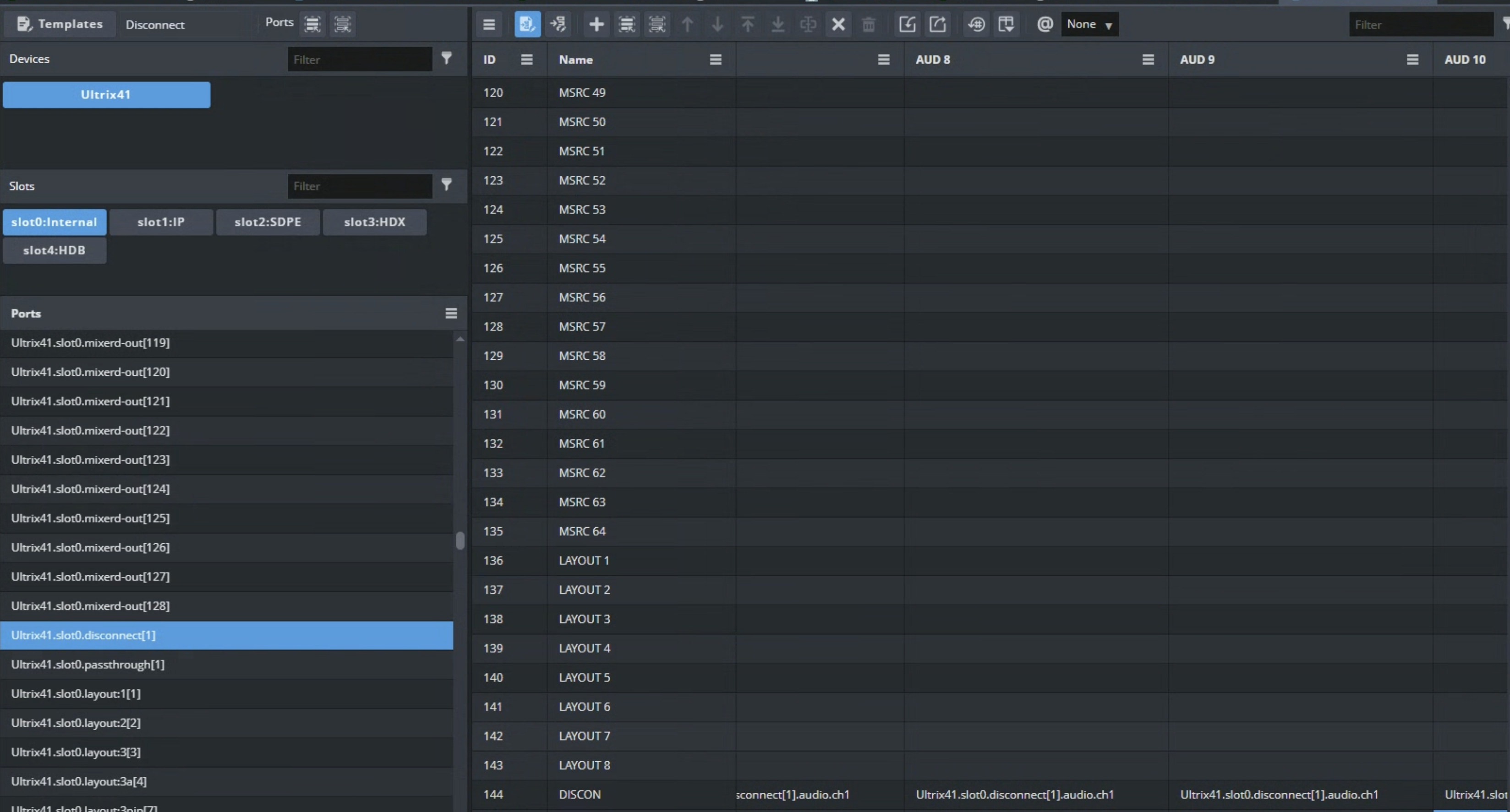

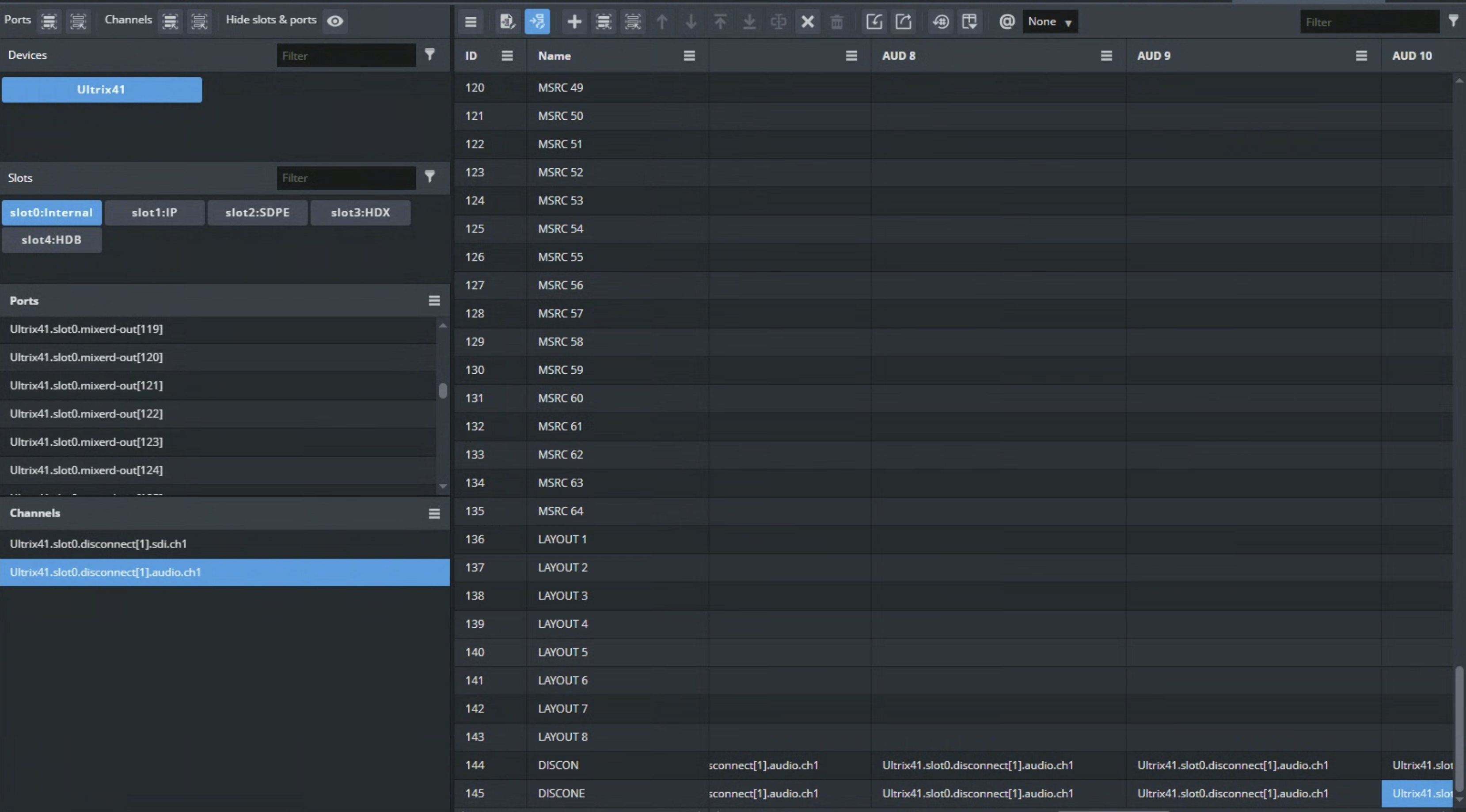

    Hi Joe, I tried it with my system as a fill source (using the Disconnect template) as well as assigning it directly with the edit tool.It looks like i can get both methods to work with version 6.7 running on an Ultrix FR2NS. what frame do you have?
    Here is an image with the fill source option.  make sure you select the disconenect template from the top menu.

    Thanks Mike, I tried it with the fill source method and it worked. Appreciate the help.
