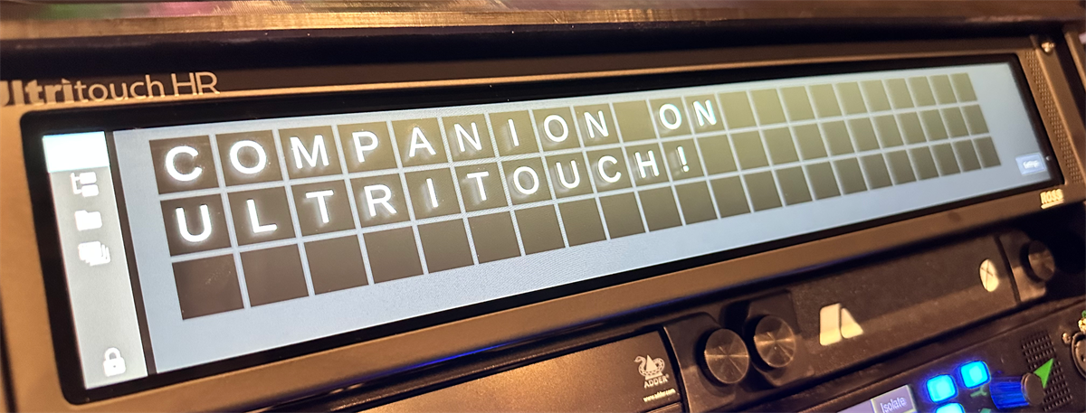

    Super helpful - thanks!! I got it working. I took it a step further - my data is base64 encoded 8-bit RGB so I am converting it to a bitmap, into a byte array, and then saving that file.
    (I've made a Dashboard panel that emulates a Bitfocus Companion Satellite Surface. This will allow users to see the actual button style in Dashboard.)

    Of course! I will release the panel open source once I'm done with my tweaks. I want to see it loaded up on an UltriTouch first and I'll provide a version of the panel sized for UT, as well as one for larger screens.

    Got it up and running today on the UT. It works great! I have a few tweaks I want to make to adjusting settings, and then I will release this.

    Soon I hope. It's been running pretty well on that Ultritouch now for a week or so. The last two things I want to do are tweak the settings modal/abs and also implement the unique id string that basically represents a serial number to Companion. Right now it's just 123456 :)

    @Seth Haberman https://techministry.blog/2025/02/04/using-ross-dashboard-and-the-companion-satellite-api-to-create-a-virtual-touch-surface-on-a-ross-video-ultritouch/
