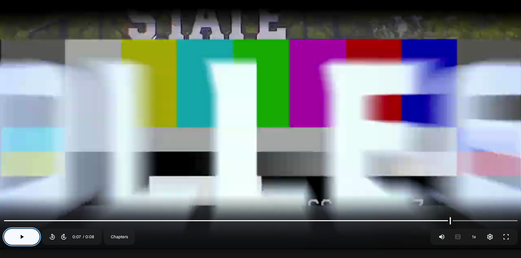

    I uploaded a video of to a Google Drive link. The first wipe was from a camera to replay ME. The second wipe was from my replay ME to a camera. I have SPOT2 now set up as video = replay ME and alpha = SPOT2. When SPOT2 fires with the alpha of the wipe, my replay ME is shown and then keys to the next source.
    Thank you!
    https://drive.google.com/file/d/1iCCXKVHhUpJbUAYTXLZYWQcGbuYSZ_8t/view?usp=sharing

    this looks like it is Not aligned -- as if the second clip is behind the first one.  so the wipe is Off.
    Also usually with a 3 channel wipe -- you would split the key for that second pair to the source that is on the PST bus (you can do this with a Bus Follow that has the key video follow the pst bus -- or inside of the custom control you build it to do a Copy of the PST bus to the Key Bus -- that way you can also ensure that you get the split setup again if it is switching on you due to Auto Key follow.  just build the extra steps into the Custom.
    I would also make sure you are not using Roll Clip for this -- instead make sure that is not in use and use the PLAY no STAT command if you are building these using VDCP control -- if you are using RossTalk you might consider looking at using the CUE command to cue each Channel and then the swap to have them fire that way.

    Thank you for the notes. On the clip's first wipe where I fire the wipe from CCU7 to the replay ME, the replay ME cuts on then the wipe fires. Should key 7 be the replay ME with the alpha being SPOT2? I'm confused why the replay ME is initially popping up.

    I would need to see the files and how they are built -- but if the ME is cut on Full then that would tell me that you have Full White on those frames and not full Black.
    did they make the key backwards? does it need to be inverted?
