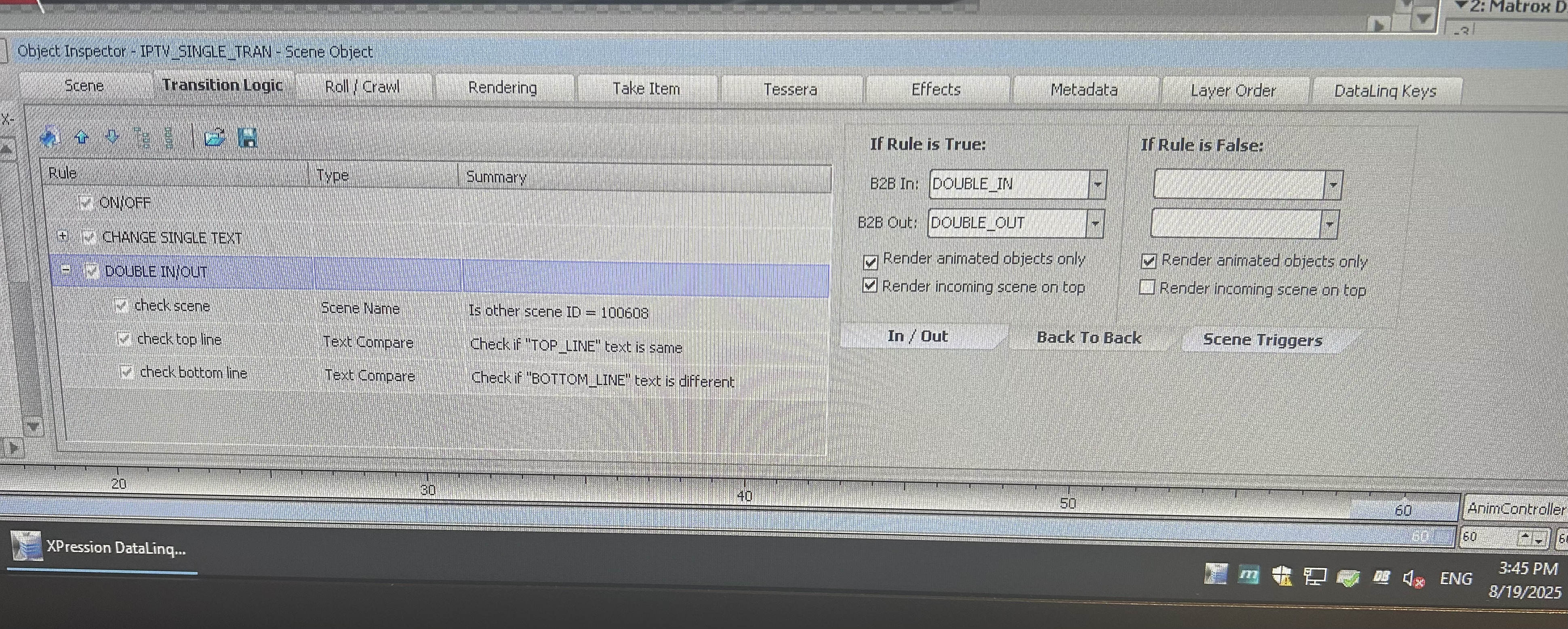

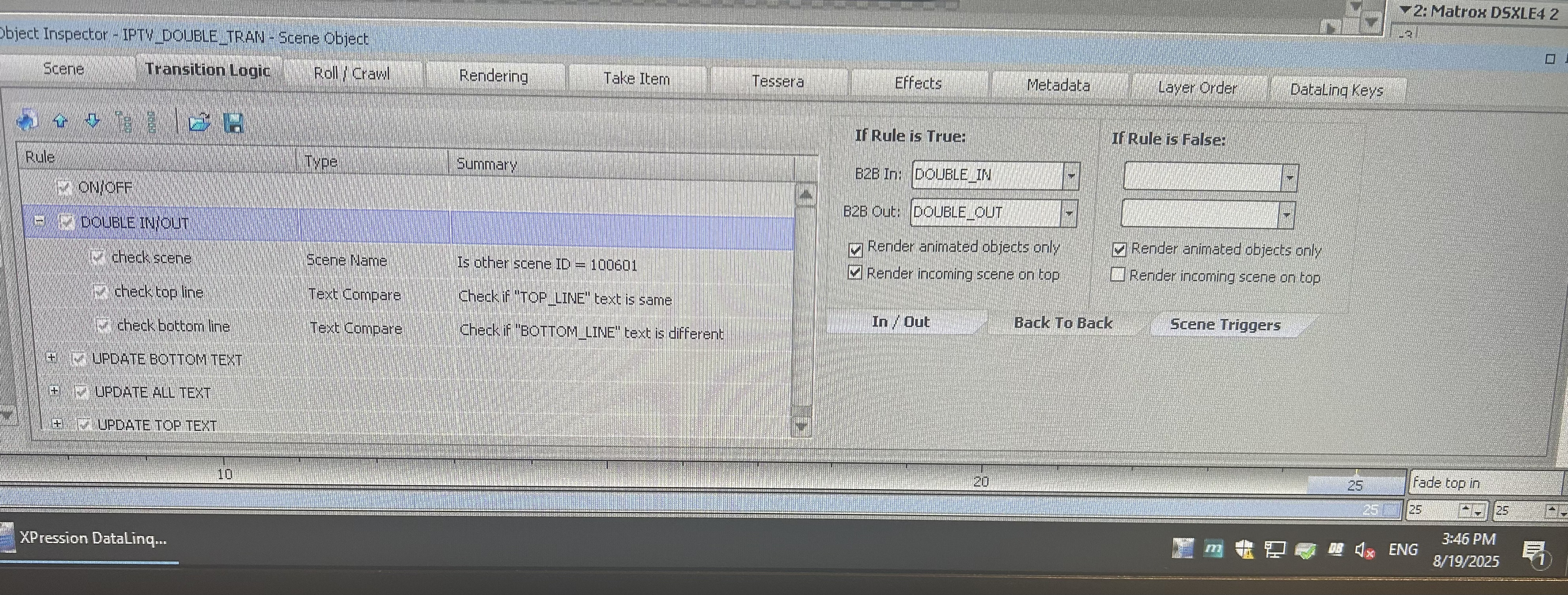

    Hi everyone,
    I have an animation built to transition my double lined lower third to a single lined lower third. This animation includes fading out the bottom line and moving down the top line to center the text.
    When I fire my single lined lower after the double line it moves the text down and back up and stays stuck at the top of the bar. However, if I fire the single lower again, it will then move into position. Attached are images of my transition logic for both the single lined lower and the double.
    Any help would be greatly appreciated!
    Single line lower transition logic:
    Double line lower transition logic:

    Sophia...difficult to know what's going on without seeing the two scenes in question. Can you post your project here so we can take a look?
