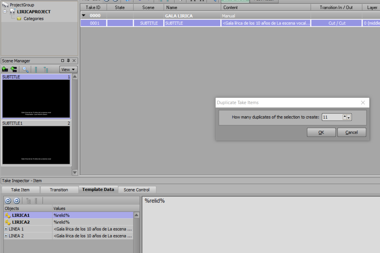

  • 1.  Duplicate items in the sequence with %relid% macro, my first line works, but not the second one
    Posted 08-02-2023 14:05
    As you can see at the capture below, the command only is working for the first line, not for the second one, I made 2 different datalinq keys, I don't know how I can do... I am pretty upset. Please someone can help me to find the solution?

    Are you trying to duplicate Take Items or Datalinq Keys? Can you explain what you need a bit more?

    Today I found the solution, editing the text for the datalinq, I could make 2 columns, and the second line is always the second column, and I solved the problem.
    Right now I just have a little problem when there is just one line, the datalinq always shows me the same text, when there is empty text, but. For now is a great success

    Finally I found the perfect solution, and everything works ok, 1 Column for upper text, and a second column for lower text, and we are happy, all the items can be copied with the duplicate command at the sequence, using datalinq keys and relid macro.
    I found a solution for the empty second line, and always is empty when there's no text.
