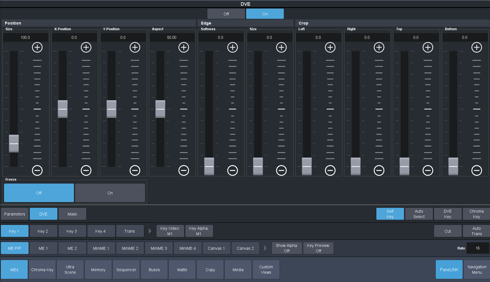

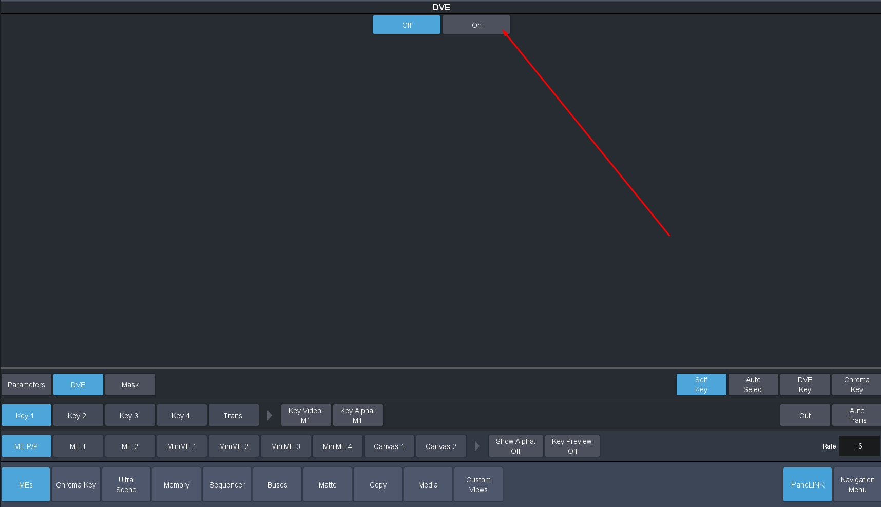

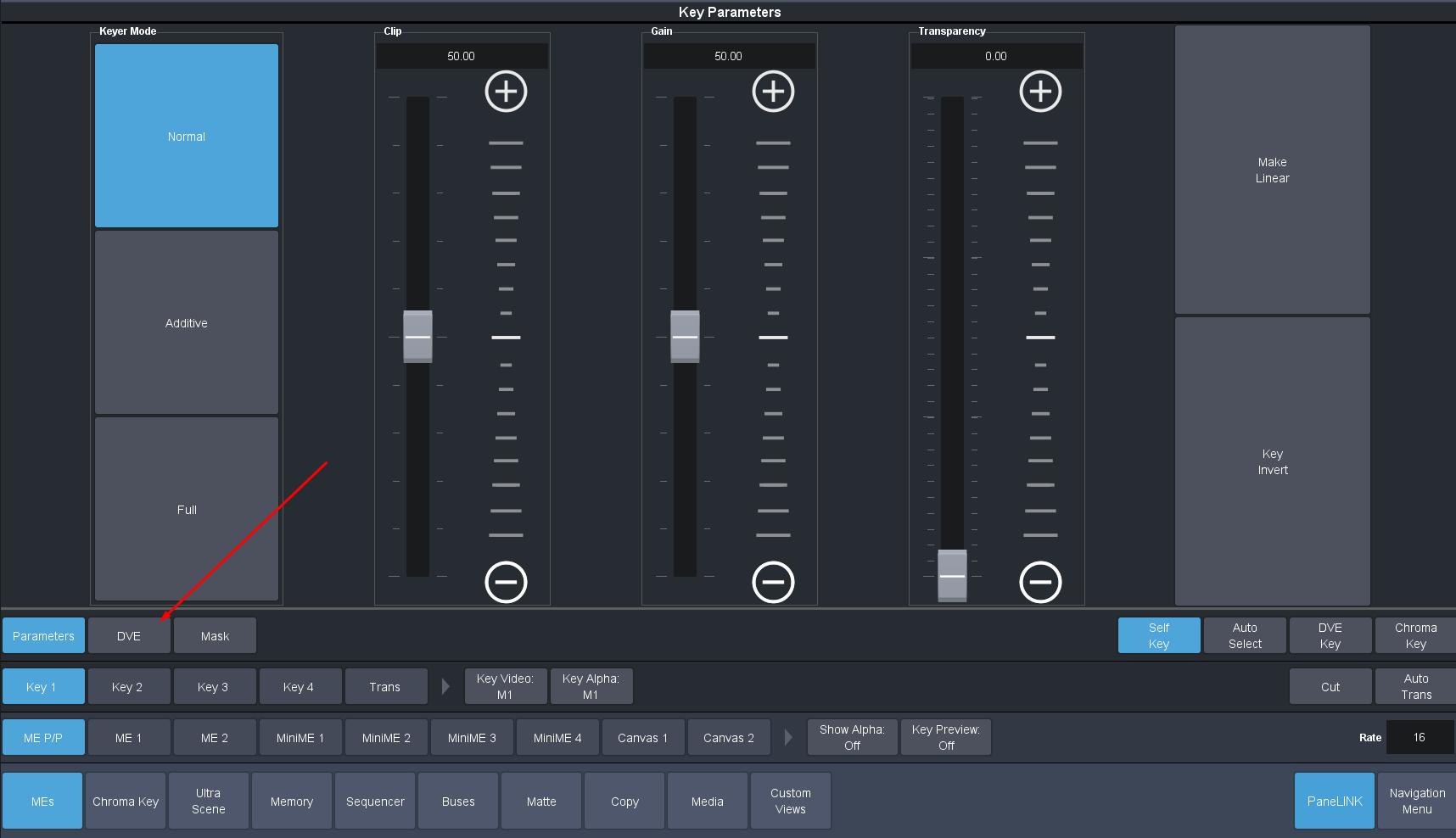

    You can fly any Keytype you would like.
    You can do it through Dashboard by Enabling it as a parameter.  Or by Holding the SELF key Button and pressing DVE.
