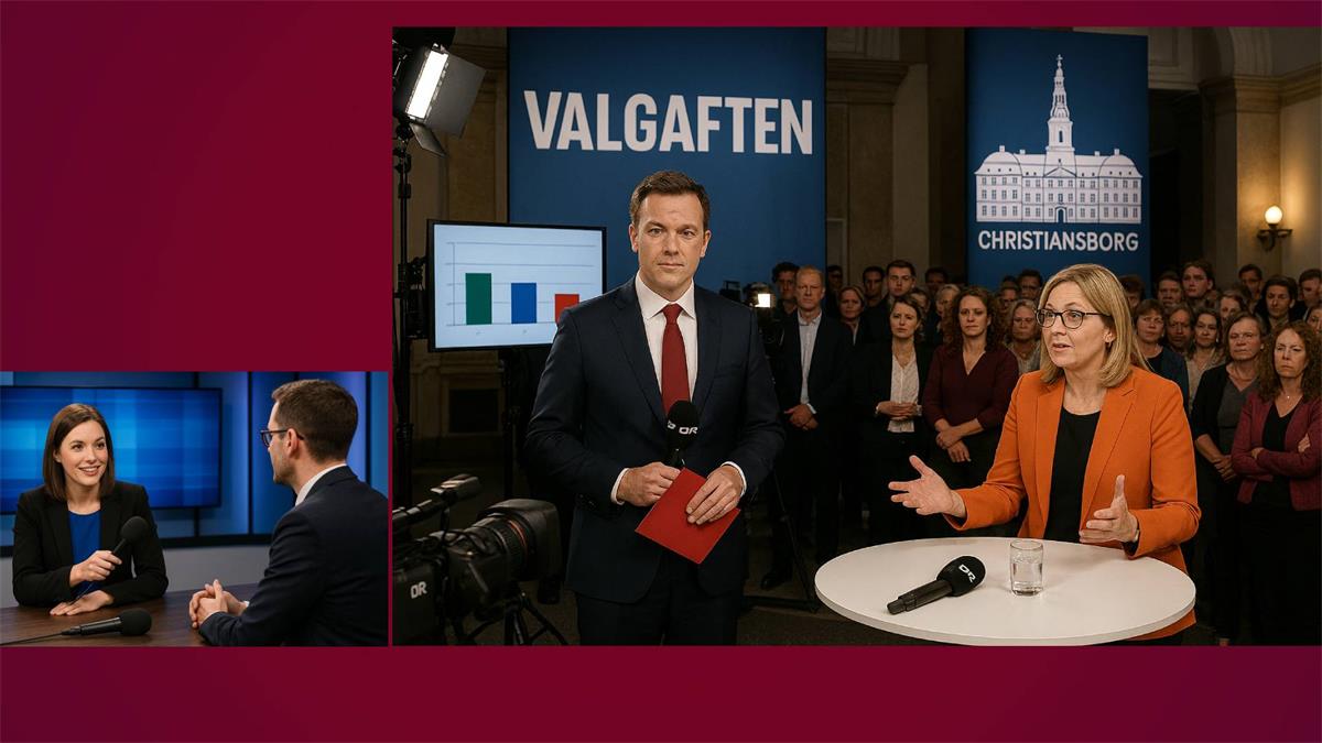

    I have stored a DVE (this is AI generated)
    DVE effect with AI generated pictures...
    It is stored as a memory and recalled in ME1, then ME1 is Cut on in ME3.
    Can I use an effect when using that workflow?

    Yes exactly, my thought was to make the big box fly out full.
    So to create that, store another memory (with the same keyers on?) and save with effect dissolve.
    But how to do when using mosart?
    Normally we cut the DVE (ME1 on ME3), and then cut to the live source.
    Any idea on how to do that?
