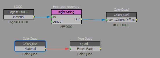

    It seems to me that XPression is not able to automatically detect the dominant color of a logo in order to adapt the color of a quad.

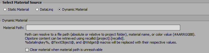

    I recommend that you add the hexadecimal code of the color in the name of your logo, which you can retrieve via Visual Logic. This will enable you to modify the color of the quad according to that of the logo.
    You can get the image path via datalinq or dynamic Material, or watch this video.
    https://www.rossvideo.com/resources/ross-university/datalinq-dynamic-materials-in-xpression/

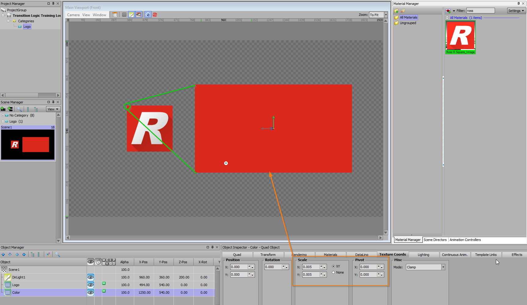

    If you have a specific point in your logo file where you want to pick the color from, you could use Texture Coordinates on the quad to "zoom in" to that color.
    In this case, I've used visual logic to copy the material I've selected for my Logo quad to the face of my Color quad
    Then on the Color quad, I've set the Texture Scale to be .005, and the Pivot to 0 and 0, so the texture is scaling out from the upper right. You can adjust the Pivot values to point to the coordinate in your texture where you would like to pull color from.
    I've seen this done where a specific color chip was included in the logo file as well, usually in the corner of the file where it could be placed outside the bounding box of the Logo's quad.
