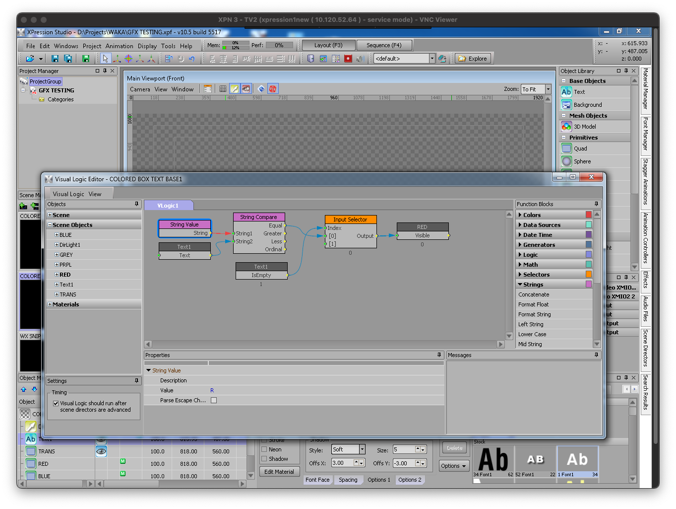

  • 4.  RE: Election Party Color Field
    Posted 10-13-2022 06:13
    Thanks guys for the help.
    I used one of the threads provided by Red and came up with a solution.
    Lee Mann
    On Air Director
    WAKA 8

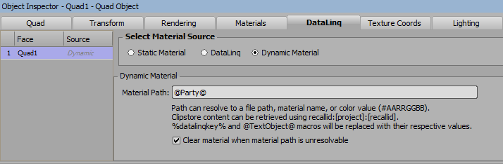

  • 5.  RE: Election Party Color Field
    Posted 10-13-2022 06:37
    Hi all.
    Lee use for that dynamic material.
    Create materials named like R with red color and D with blue color. In the quad select dynamic material and set  a text object name @Party@
    https://livinglive.community/discussion/visual-logic-color-change-based-on-datalinq-strings?ReturnUrl=%2fcommunities%2fcommunity-home%2fdigestviewer%3fcommunitykey%3d91812bfd-9393-4a3f-8a74-7f8035df130e
