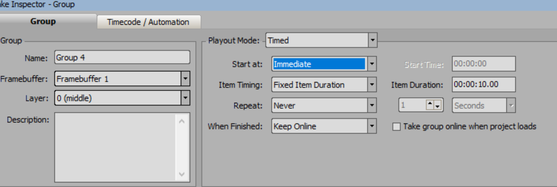

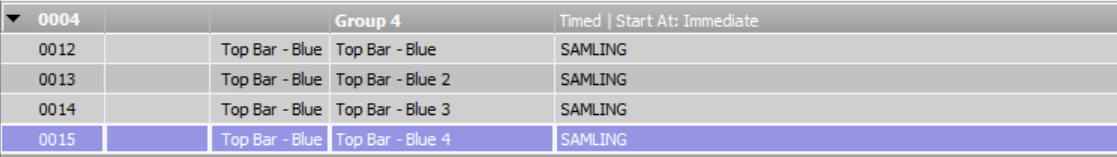

I'm using a single, looping scene director with two scripts. At the front of the SD is a script that refreshes the datalinqs based on the current race number. At the end is a script that set the race number. That is based on whether or not the producer only wants to show winners and, if not, keeps track of the number of candidates in a race before going to the next race. The scene itself has hidden text boxes linked to the Datalinq which then sets party colors, party icons, and winner flags based on the data. Script is below and
here's a sample scene (some elements may not have exported, but scripts are there).
