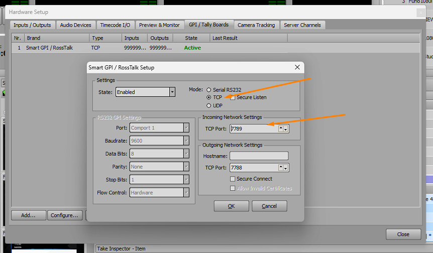

    That is an issue with Companion in that it will take control of the port and "lock it up"
    you would be best to setup a second GPI/RossTalk board in XPression with a different port to use for Companion / Switcher etc.
    I can't remember if companion will allow you to change the port it uses to something other than 7788 .. if that is the case then you will need to change the port that the Carbonite is using.

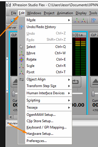

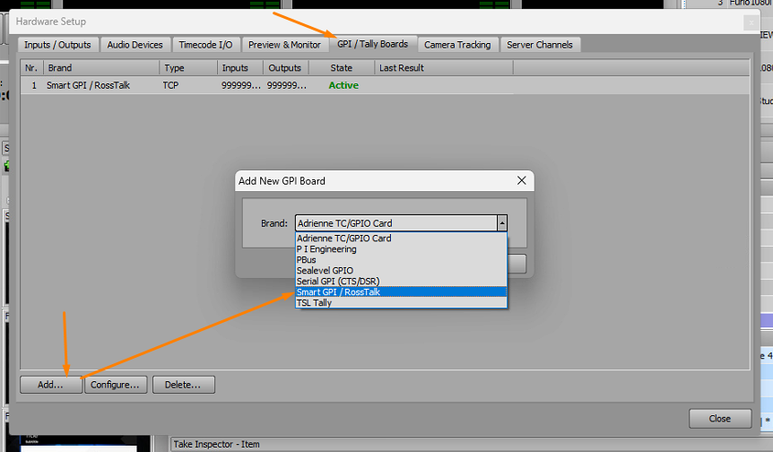

    Edit - Hardware Setup
    GPI/Tally Board -- Add -- Smart GPI/RossTalk
    Make sure to set TCP and a different port than the other one (default is 7788) like shown here to 7789 and make sure nothing else on the computer is using that port either.
