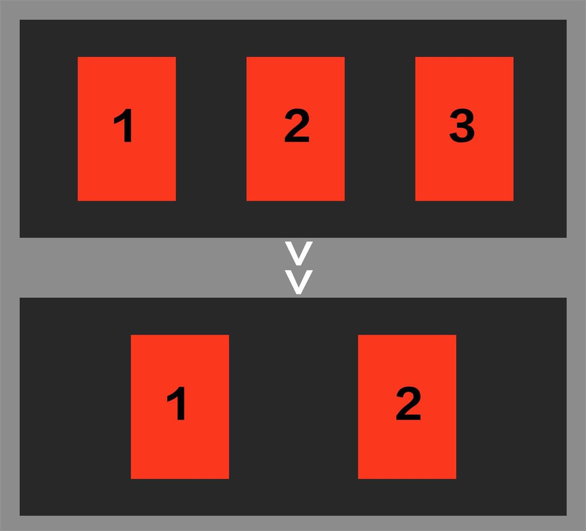

I wrote this onto a text object that's connected to the vis of all three added together so any time 1 of the turns invisible it will trigger the others to animate.
Here is the script however I have also attached the project for you to look at.

Sent: 10-09-2022 22:42
From: alan
Subject: Equal distribution of quad
Hide any quad,Not just quad3.
When one of the quads is hidden, the remaining two quads will have a moving animation
that is evenly distributed on the canvas
alan
Sent: 10-09-2022 12:20
From: Simon Redmile
Do you mean that when you hide quad 3 it animations to the new position or is a jump ok?
Sent: 10-09-2022 05:17
From: alan
hi there
Three quads are equally distributed on the canvas. When one of the quads disappears, the remaining two quads are equally distributed on the canvas.
Besides, there is a silky moving animation.
1 or 0 controls the hide and display of quad
How to do it
alan
