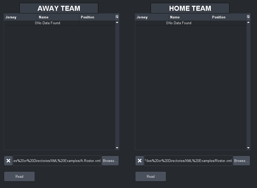

Thanks for using and confirming the functionality of the home table. I used the grid panel code from the previous message and it works fine and the code looks good too. Can you please confirm that the XML file that you are using for the away table follows the pattern of the a.Roster.xml that you attached previously?

I put this into my code, and it worked great! Except for the Away team read button, it is not populating the Away table.

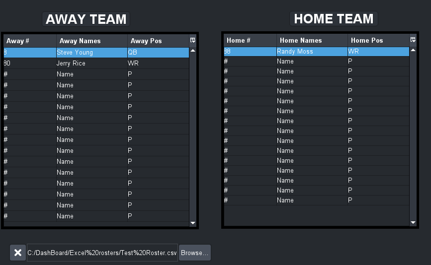

I am trying to make it easy for Graphics operator to receive .csv file and import it into a table that looks like so.
I have read some other posts about file pickers and am not quite understanding how to construct the table.
Thanks for your help!
