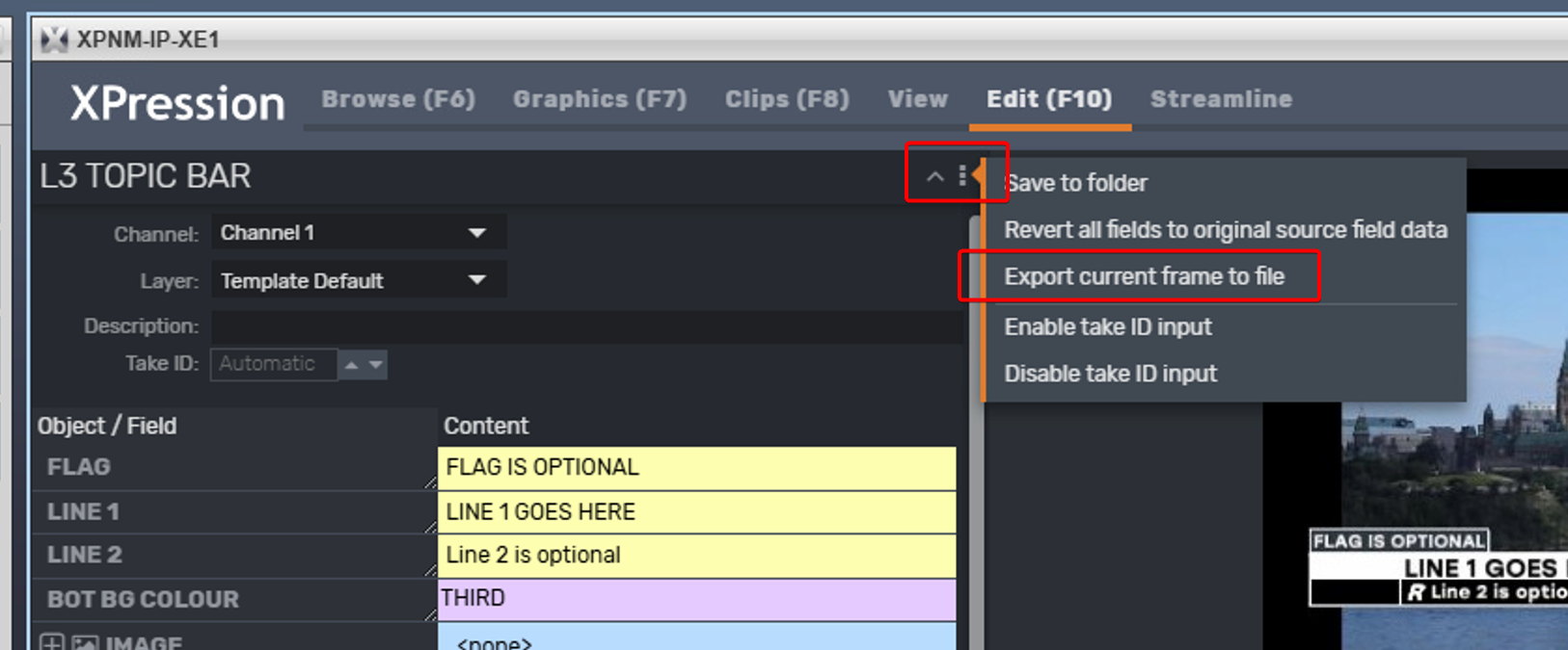

    We noticed that users are no longer able to right click on the preview and export as PNG.  Was this feature removed or is there a way to make this possible again?

    Did you also switch from the ActiveX to the HTML5 plugin?

    If you click on the 3 dot menu you will find the "export current frame to file" feature:
