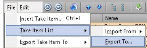

    Hi, was wondering if it is possible to bind the Sequencer's File>Take Item List>Export To... to a keyboard shortcut? I can only see an option for a keyboard map on the Export Take Item To..., not the entire take item list. V12

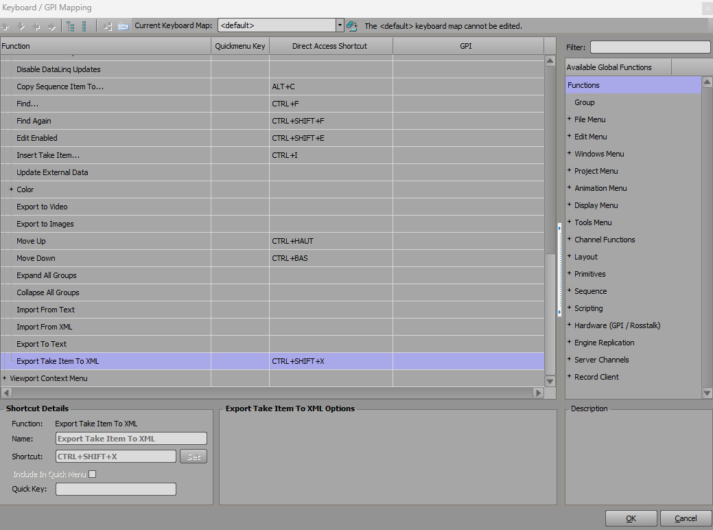

    The default keyboard shortcut CTRL + SHIFT + X lets you quickly open the "export to" page. You can also customize it by choosing your preferred shortcut in the Keyboard / GPI Mapping page.

    Yeah see that only exports the selected take item though. I need to be able to export the entire take item list instead.
