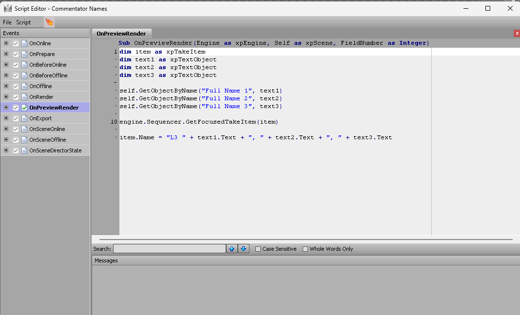

  • 5.  RE: Field text to Sequencer item name
    Posted 10-10-2025 01:48
    Could you please upload some screenshots of how you did it and one of your results?
    Thank you.
    Alejandro Galvan
    LA36 LOS ANGELES TV ACCESS
  • 6.  RE: Field text to Sequencer item name
    Posted 10-11-2025 13:56
    Here it goes.
    The result was:
    "L3 Joe Smith, Jack Furly, Tina Robson"
    Paulo Dias
  • 7.  RE: Field text to Sequencer item name
    Posted 10-12-2025 05:48
    I would use ampersand "&" instead of plus "+" in future just incase you get into doing mathematics, using plus symble will get confusing, other than that, nice one!

    I'll hop in to offer one more improvement:
    Instead of using Engine.Sequencer.GetFocusedTakeItem (which could theoretically end up changing the wrong take item, if another program asked for a preview render while you were focused on something else), you can just use Self.GetTakeItem(item) which will always pull the take item that this scene is attached to (if it is attached to one)
    Zachary Fradette
    United States
  • 12.  RE: Field text to Sequencer item name
    Posted 10-20-2025 08:36
    How would you type in the title if its not in focus :P
    I do agree though it's probably safer.
