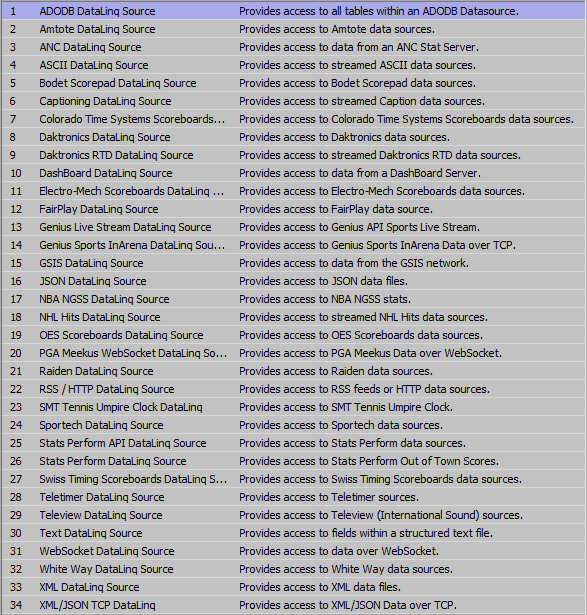

    Hi. Besides excel, what other worksheets does xpression like? Where can I find a list to give to my boss? Thank you.

    Well there's everything listed in here;
    Via ADODB you can use most database types.
    Via ASCII you can use most other things.
    Its a very flexible system so that why I asked what you want to use, as that's usually a better approach.
  • 5.  RE: Files that datalinq uses.
    Posted 02-13-2026 10:26
    Any database that Windows ODBC can connect to Datalinq can as well.
