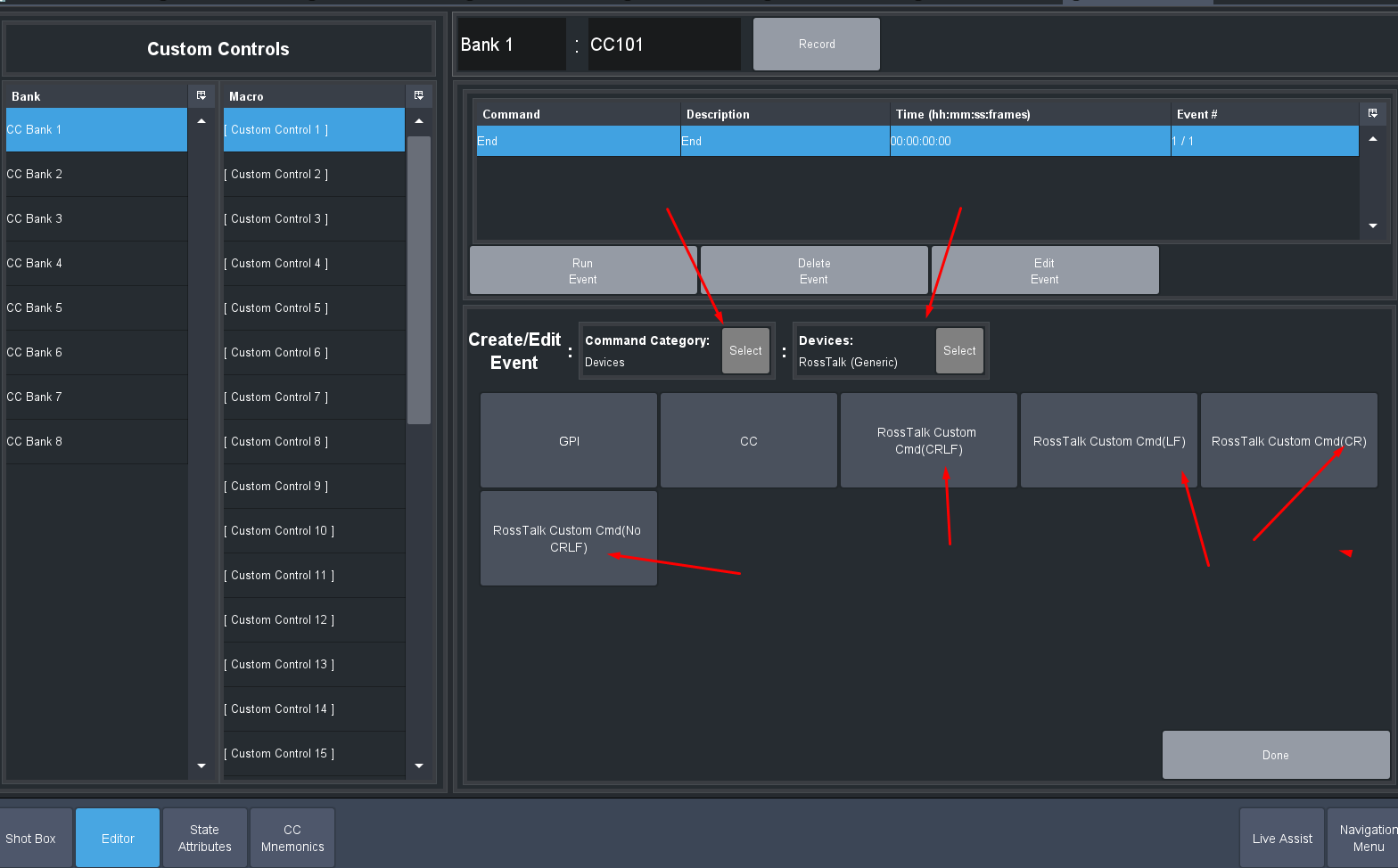

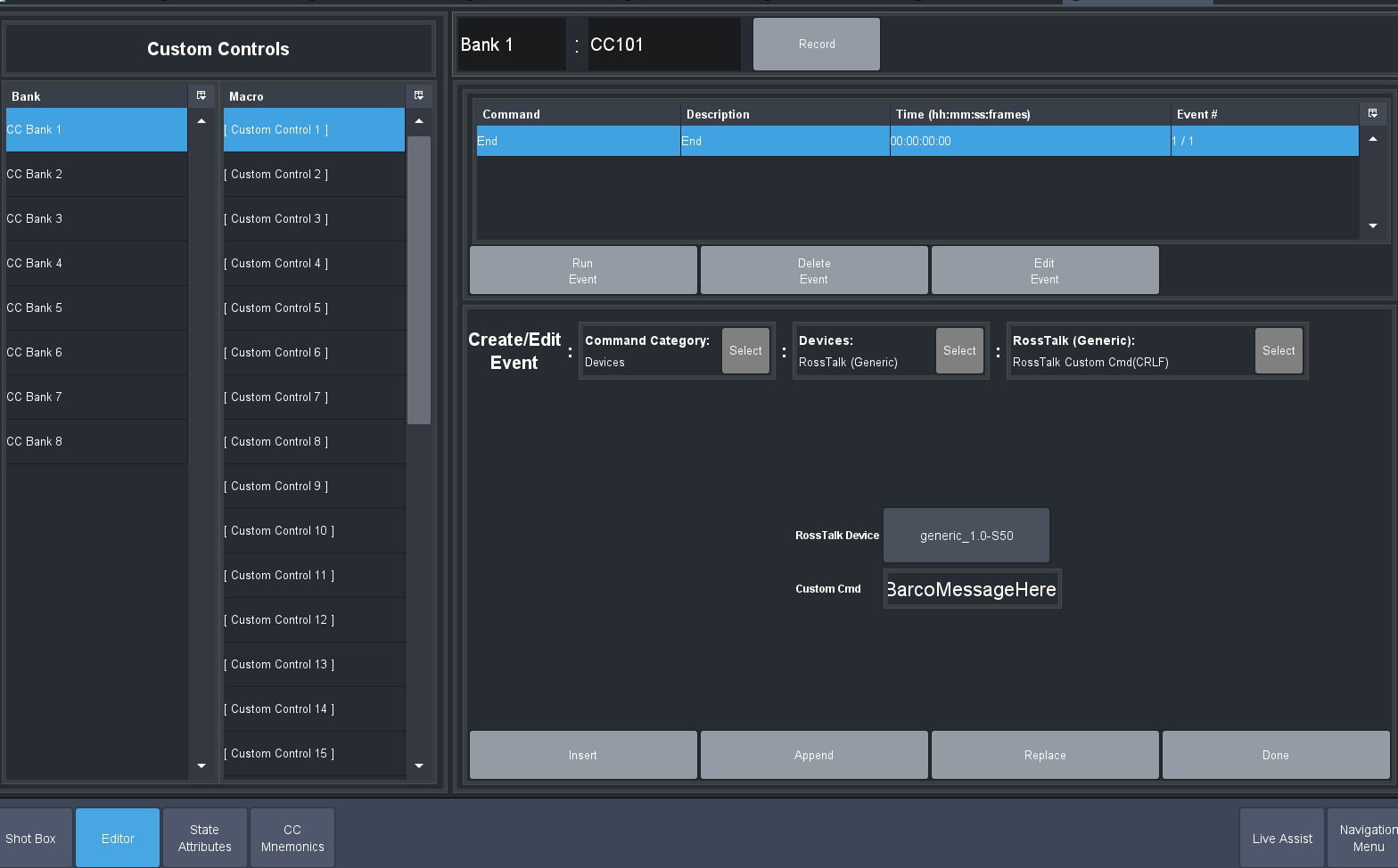

    Can you give an example of what the message needs to look like to a Barco?
    RossTalk is opening up a Port and then Firing ASCII Text at the device.
    Also some devices what a different "end of message" .. which we have different options for that..
    There you can see when entering a "Custom Message" you pick from:
    1 - CRLF which is the message ending with Carriage Return and Line Feed are send
    2- LF just Line Feed is send
    3- CR just Carriage Return is sent
    4- NO CR or LF is sent
    Hope that helps...  but without knowing what the other side is looking for can't give more suggestions than that.
