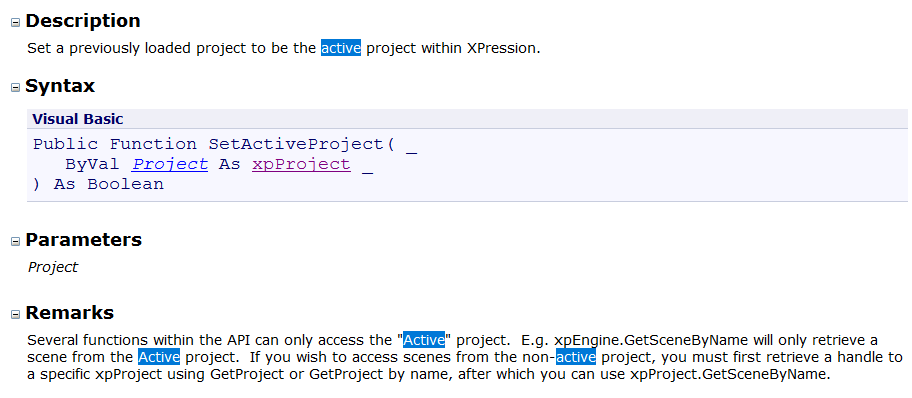

Excellent, pleased I could point you in the right direction. :)
Sent: 07-04-2022 08:37
From: Svetlin Aleksandrov
Subject: Get Data/Content from currently online scene

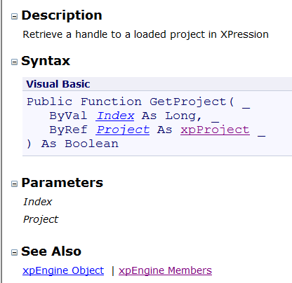

Yup, adding those 2 lines before everything else has solve the problem
Engine.GetProject(0, project)Engine.SetActiveProject(project)
maybe I will change GetProject to GetProjectByName for the final version
Tnx Red,
very fast and helpful responses from you!

Checking the SDK looks like you can set project to active.
Under engine there's a get project property.
I think you could probably put a engine.GetProject then set as active?

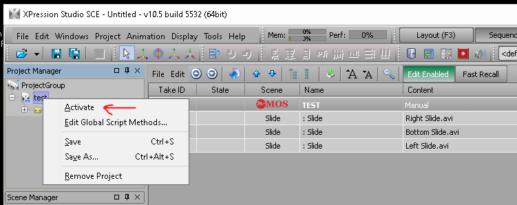

Hey Red,
I've hit a wall. Everything is working properly from Xpression Sequencer, but when the slides are loaded trough Inception then the script is failing and not working. I've found that you should "Activate" the project on order to work
but unfortunately that cannot happen cuz the studio cg operators are working on a remote sequencer and they have no access to Xpression Studio machines.
Is there any workaround that you can suggest?

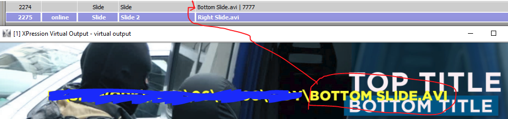

Sent: 07-01-2022 09:45
Tnx Red,
that worked. I was able to pull the full path of the video form the online scene.
dim fb as xpOutputFrameBuffer
dim prevScene as xpScene
dim bg as xpBackgroundObject
dim mat as xpMaterial
dim matLayer as xpMaterialLayer
dim video as xpBaseShader
dim txt as xpTextObject
Engine.GetOutputFrameBuffer(0,fb)
fb.GetSceneOnLayer(0, prevScene)
prevScene.GetObjectByName("Video", bg)
bg.GetMaterial(0, mat)
mat.GetShader(0, video)
Self.GetObjectByName("Text1", txt)
txt.Text = video.FileName

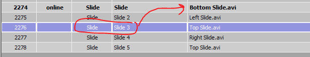

Sent: 07-01-2022 07:15
Is it possible to pull data from the current played scene in sequencer to the one to be played? I need the scene to know which video is loaded in the scene that is currently online. So next scene to be played to do animation based on the video loaded in current scene that is online.
So Slide3 should know which video is in the slide that is online.
Also I wrote this to get the video name in the current scene, but how to get it from the one that is online?
dim layer as xpMaterialLayer
dim videoName as String
Engine.GetMaterialByName("Mat1", mat)
mat.GetLayer(1,layer)
layer.GetShaderByName("Video", video)
videoName = video.FileName
