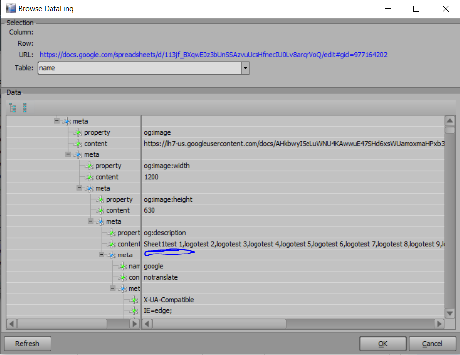

Tamer,
You won't be able to just use the URL of the sheet...You'll need to publish each table to the web as a CSV file, then set up separate Datalinq sources for each table.
All of the steps are shown in this video:

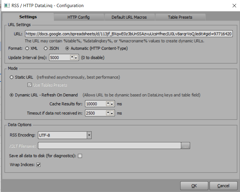

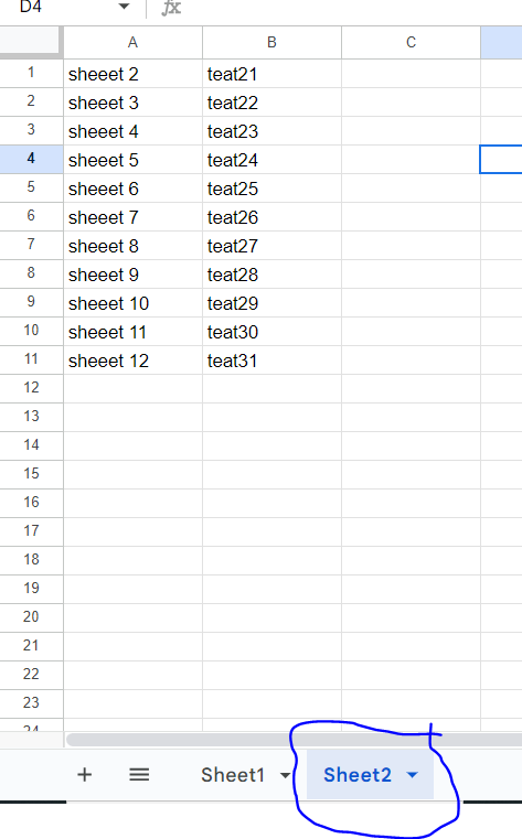

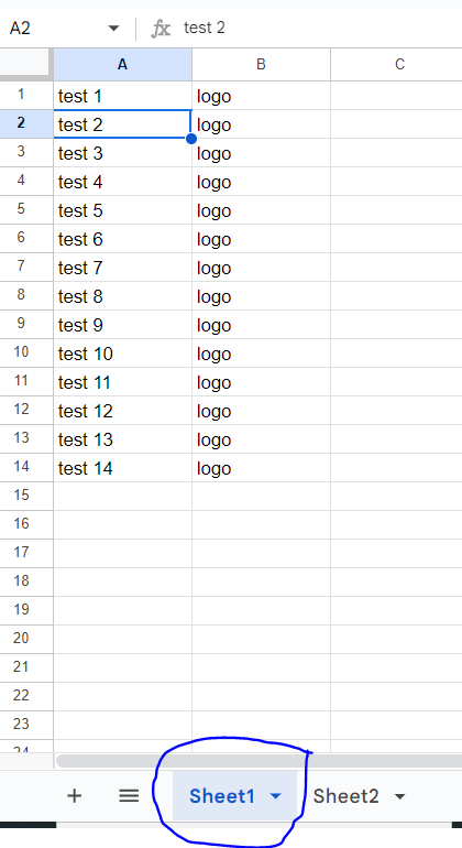

1st* I create a google sheet as a test and add sheet1 sheet2
2nd* I copy the link to Rss / HTTP Datalinq Source and make it dynamic URL

1- when i Browse the data i find only sheet1 plus all in one line ( so how i can find sheet 2 )

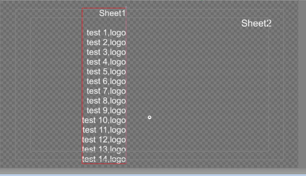

2- when i link it to text it reeds all caulomes and cells in one text ( so how i can link every cell in 1 text as excel

there is attached phots
and the google sheet link
https://docs.google.com/spreadsheets/d/113jf_BXqwE0z3bUnSSAzvuUcsHfnecIU0Lv8arqrVoQ/edit#gid=0
