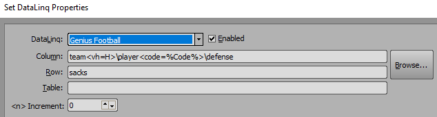

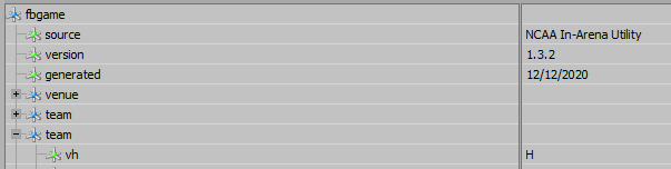

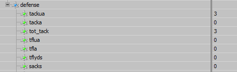

Yeah for sure, so it would be something like this;
so the reason I am doing a search in team for vh=H is because I want the home team so that's a fixed value I am looking for for team.
Then I am looking for play code in the data because in this case I am looking at College Football and player numbers are repeated so we use codes for look up rather than number.
So inside there data tree the above is taking me to
the second lookup is taking me to here
then finally to defense stats and to sacks in this example
Sent: 07-24-2023 16:45

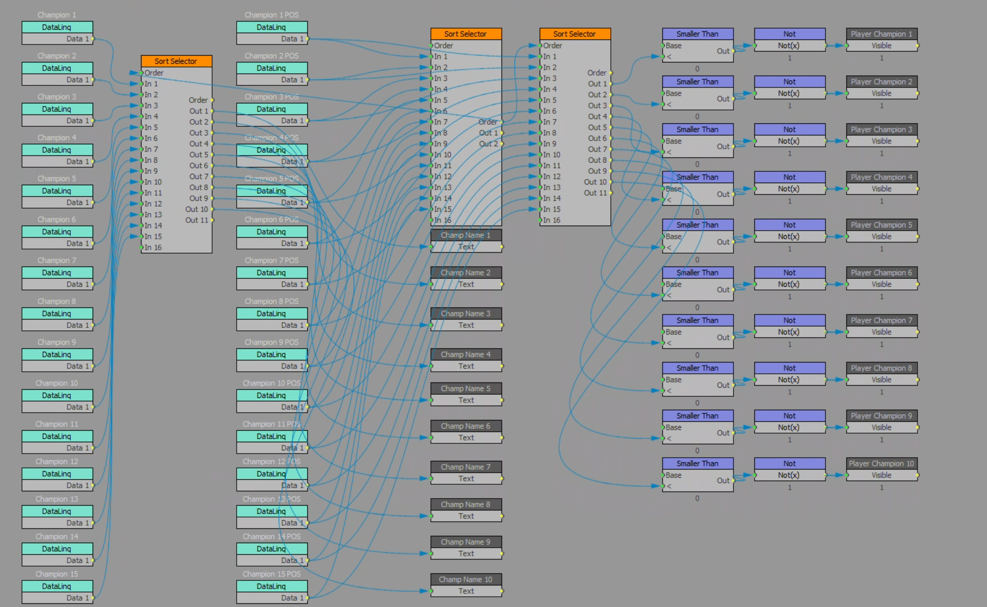

This is almost definitely your issue.
My guess is when the scene comes online and looks at that macro to resolve the path the visual logic isn't complete yet so that text object doesn't yet say the path name you're expecting.

Correct! Essentially how it goes currently is I have my visual logic looking at 15 possible objects in my JSON data (keep in mind this is per player so there would be 8 of these total). We have 10 display spots for images, and some of those 15 are not relevant so I have sort selectors looking at values relevant to each attribute (in this case each characters current position to see if they are being used or not). I then use sort selectors to order the datalinqs in a way that it prioritizes those characters that are in play first, then puts the out of play characters on the back end of those 10 possible spots. I then have it recheck the board position of those characters and if they are not on the board currently it will hide them from being visible. This then determines the correct order for these character names and applies them to hidden text objects within the graphic, which are then used as @textobject@ macros to complete dynamic material paths in order to display the images of the correctly ordered characters and their related attributes/info.
Here is the per player visual logic I currently have running:

To complete the dynamic path are you using any macros such as @textobject@?
