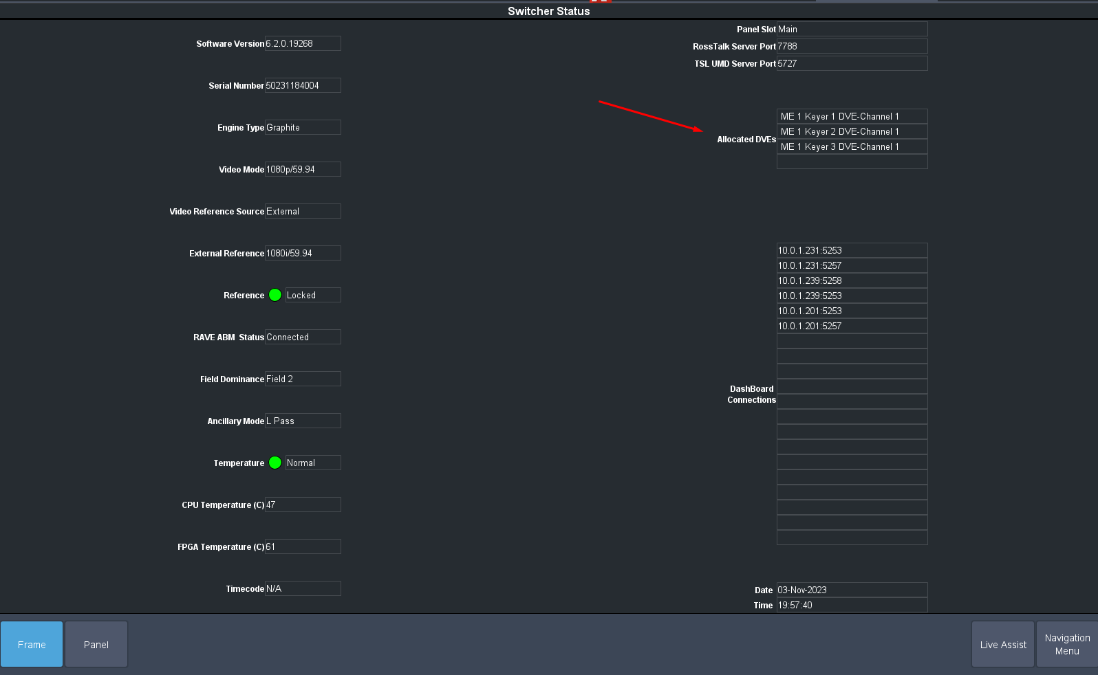

    In Carbonite 7.1.5/TD2, where can I see the DVE resources? It looks like I have 8 but I'd like to be able to see where they might be in use when I get DVE-happy ... as one does these days .. without digging through MEs.

    It's on the Status Page.
    This is a Graphite so only 4 channels but it's in the same spot on the Ultra..
