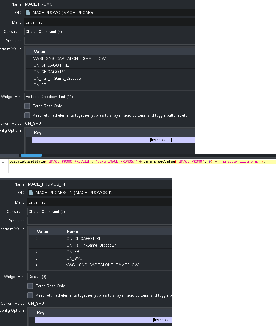

    Hi All, I'm fairly new to DashBoard, so I'm hoping someone will have an easy answer for this.  I am using the "Value" of a parameter to select an image for preview.  My parameter and the script I am using are the upper 2 items in the attached image.  I am searching for the script that will return the "Name" from the selected item in the paramater at the bottom of the image.  None of my attempts have worked, so I am hoping the experts here can help me out.  My thanks for any info you can pass along.
    I'm looking for script to return value of the selected
    Kraig

    Hi Kraig, to get a name of an integer param use params.getValueAsString()
    var name = params.getValueAsString('IMAGE_PROMOS_IN', 0);
