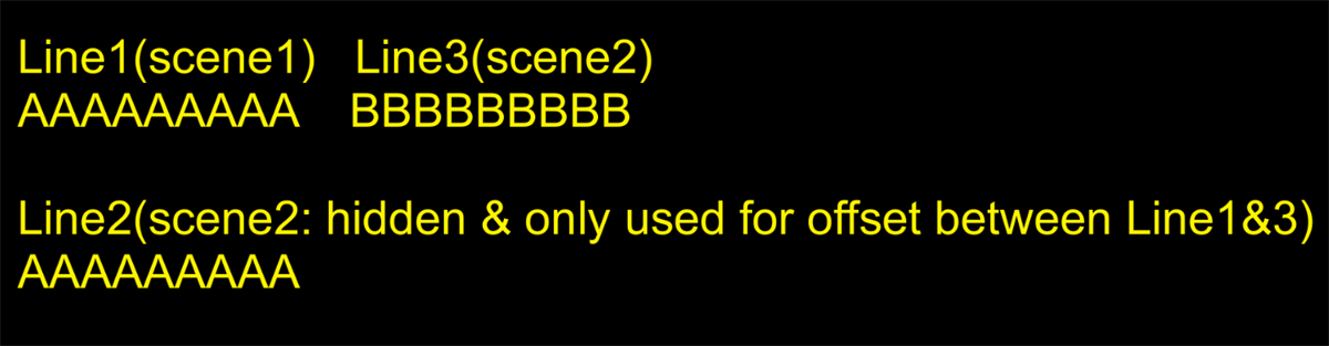

    Thank you for sending the scripted scene. But this is not exactly i want my scene to behave. Perhaps i didnot explain my requirements properly in my post.
    As per the current script, i have to take SCENE2 onair 1st and then take SCENE1 onair and then the line data of SCENE1 sets into the line data of SCENE2.
    What i want is, i take SCENE1 online 1st and when i take SCENE2 online the line data of SCENE1 'is already set' into the line data of SCENE2.
    To explain how my scene structure is:
    I have 2 graphic scene
    1. SCENE1 which has Line1
    2. SCENE2 which has Line2 & 3
    In SCENE2 i want the Line3 to move in X pos as per SCENE1 Line1 text bounding box width.
    For that i need to store data of Line1 of SCENE1 into Line2 of SCENE2 so that i can do VL offset between Line2 & 3 in SCENE2. The Line2 reference text in SCENE2 graphic will always be hidden.
    And this setting of text should only function when i am taking SCENE1 onair 1st and then i take SCENE2 onair.
    Hope this explanation makes sense.
