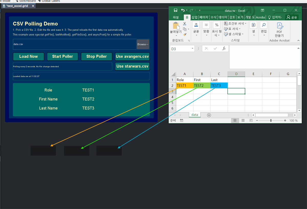

    Hi everyone,
    I am looking for a way to connect an Excel spreadsheet with Ross DashBoard, but I'm not sure how to go about it.
    My goal is simple : when I type a number or text into cell A1 in Excel, I want that specific value to be displayed inside my DashBoard panel in real-time (or near real-time).
    What is the best way to achieve this? Should I use ogScript to read a CSV/XML file, or is there a better workflow for Excel integration?
    Any advice, examples, or sample scripts would be greatly appreciated.
    Thank you!

    Polling a CSV is going to be your fastest path to success.  DashBoard does not have any native decoder for Excel's binary document types so reading the CSV text and using one of the existing examples (in this forum) will be the simplest mechanism to access the data from your sheet.

    Hi James,
    I have confirmed that I need to save it as a CSV file and import it from DashBoard.
    It helped me a lot. Thank you so much!

    The simplest and most reliable approach is usually not to read the Excel workbook directly from DashBoard. Instead, have Excel save or export the value you need to a small CSV or JSON file, then let DashBoard poll that file every second or two with ogScript.
    For your example, if you only need the value from cell A1, a very straightforward workflow is:
    1. Excel writes the current value of A1 to a file such as value.csv
    2. A DashBoard panel uses a timer or poller in ogScript
    3. The panel checks whether the file changed
    4. If it changed, DashBoard reloads the file and updates the panel
    That gives you near real-time updates and is easy to understand and support.
    A few practical notes:
    • CSV is usually the best option if you only need one or a few values
    • XML or JSON can be better if you want named fields or more structured data
    • DashBoard does not generally treat a live .xlsx file as a real-time data source, so using an exported file is the cleaner workflow
    • If you want true live integration without manual saving, then Excel would need a macro, script, or external process to automatically write out the latest value whenever the sheet changes
    So in short: for a simple and customer-friendly solution, I would recommend Excel -> CSV file -> DashBoard ogScript poller.
    If helpful, here is a small DashBoard ogScript example that watches a CSV file and updates a panel automatically when the file is saved.

  • 5.  RE: How to link Excel to DashBoard?
    Posted 07-20-2026 22:56
    Hi Richard,
    Thank you so much for sharing the script.
    Thanks to your help, I now see the possibility of importing a CSV file and viewing the cell text directly on the dashboard.
    If you don't mind, I would like to ask a few follow-up
    Questions a few things :
    1. Is it only possible to view the data by explicitly importing the CSV file from the dashboard every time?I would like to know if there is a way to automate this or if manual importing is the only method.
    2. Could you please check the attached image?As shown in the image, my goal is to make the text from the Excel/CSV file automatically appear in the dashboard's Text input field.
    I reviewed the script you sent entirely, but since I am not from a coding background, I am having trouble identifying the specific part of the code that pulls the Excel data into the dashboard.
    3. If it is not too much trouble, could you please share a simple script that extracts data from a CSV file and displays it on the dashboard?Any simplified example or guidance on where to inject the data values would be greatly appreciated.
    Thank you so much for your time and support!
    DK Han

  • 6.  RE: How to link Excel to DashBoard?
    Posted 21 days ago
    Yes, the file loading can be fully automated - the dashboard can simply load a predefined file on startup. Based on Richard's great example, I put together a more compact version that always reads the contents of a file named data.csv and displays the fields shown in the screenshot.
    To keep the example as clear as possible, I stripped out several sections from the original version. In this simplified demo the three fields are just named A, B, and C in the code.
    <?xml version="1.0" encoding="UTF-8"?><abs contexttype="opengear" gridsize="20" id="_top" keepalive="false">
       <meta>
          <params>
             <param access="1" maxlength="0" name="File Path" oid="file.path" type="STRING" value="data.csv" widget="label"/>
             <param access="1" maxlength="0" name="A" oid="A" type="STRING" value="TEST1" widget="label"/>
             <param access="1" maxlength="0" name="B" oid="B" type="STRING" value="TEST2" widget="label"/>
             <param access="1" maxlength="0" name="C" oid="C" type="STRING" value="TEST3" widget="label"/>
          </params>
          <api>var POLL_TIMER_NAME = 'csvPollTimer';
    var POLL_INTERVAL_MS = 2000;
    function trimValue(value) {
       if (value == null) {
          return '';
       return String(value).replace(/^\s+|\s+$/g, '');
    function clearLabels() {
       params.setValue('A', 0, '');
       params.setValue('B', 0, '');
       params.setValue('C', 0, '');
    function splitCsvLine(line) {
       var rawColumns = String(line).split(',');
       var cleanColumns = [];
       var i;
       for (i = 0; i &lt; rawColumns.length; i++) {
          cleanColumns.push(trimValue(rawColumns[i]));
       return cleanColumns;
    function getFileChangeToken(filePath) {
       var file = ogscript.getFile(filePath);
       if (file == null || !file.exists() || !file.isFile()) {
          return null;
       return String(file.lastModified()) + ':' + String(ogscript.getFileSize(filePath));
    function updatePanelFromCsv(fileContent, filePath) {
       var rows;
       var i;
       var dataRow = null;
       var columns;
       if (fileContent == null) {
          clearLabels();
          ogscript.debug("Could not read the CSV file.");
          return;
       rows = String(fileContent).replace(/\r/g, '').split('\n');
       for (i = 1; i &lt; rows.length; i++) {
          if (trimValue(rows[i]) != '') {
             dataRow = rows[i];
             break;
       if (dataRow == null) {
          clearLabels();
          ogscript.debug('CSV loaded, but there are no data rows yet.');
          return;
       columns = splitCsvLine(dataRow);
       params.setValue('A', 0, columns.length &gt; 0 ? columns[0] : '');
       params.setValue('B', 0, columns.length &gt; 1 ? columns[1] : '');
       params.setValue('C', 0, columns.length &gt; 2 ? columns[2] : '');
       // ogscript.debug('CSV loaded successfully.');
    function loadSelectedCsv() {
       var filePath = params.getValue('file.path', 0);
       if (filePath == '') {
          clearLabels();
          ogscript.debug('File name is missing...');
          return;
       ogscript.asyncPost(filePath, null, function(fileContent) {
          updatePanelFromCsv(fileContent, filePath);
          if (fileContent != null) {
             ogscript.putString('csv.poll.token', getFileChangeToken(filePath));
    function pollCsvFile() {
       var currentToken;
       var previousToken;
          clearLabels();
          ogscript.debug('CSV filepath is missing...');
          return;
       currentToken = getFileChangeToken(filePath);
       if (currentToken == null) {
          clearLabels();
          ogscript.debug('CSV file not found.');
          ogscript.putString('csv.poll.token', '');
          return;
       previousToken = ogscript.getString('csv.poll.token');
       if (previousToken != currentToken || previousToken == null || previousToken == '') {
          loadSelectedCsv();
          return;
    function initialisePoller() {
       clearLabels();
       try {
          ogscript.cancelTimer(POLL_TIMER_NAME);
       } catch (error) {
       ogscript.installTimer(POLL_TIMER_NAME, true, POLL_INTERVAL_MS, POLL_INTERVAL_MS, pollCsvFile);
       ogscript.debug('Starting poller. Waiting for file changes.');
       pollCsvFile();
    }</api>
          <ogscript handles="onload">initialisePoller();</ogscript>
       </meta>
       <abs height="500" left="20" top="20" width="600">
          <label height="34" left="20" name="CSV Polling" style="size:Bigger;font:bold;" top="20" width="200"/>
          <abs height="200" left="20" top="100" width="500">
             <simplegrid cols="3" height="100" hspace="8" left="20" rows="1" top="18" vspace="8" width="400">
                <param expand="true" oid="A" showlabel="false" style="style:text.value;"/>
                <param expand="true" oid="B" showlabel="false" style="style:text.value;"/>
                <param expand="true" oid="C" showlabel="false" style="style:text.value;"/>
             </simplegrid>
