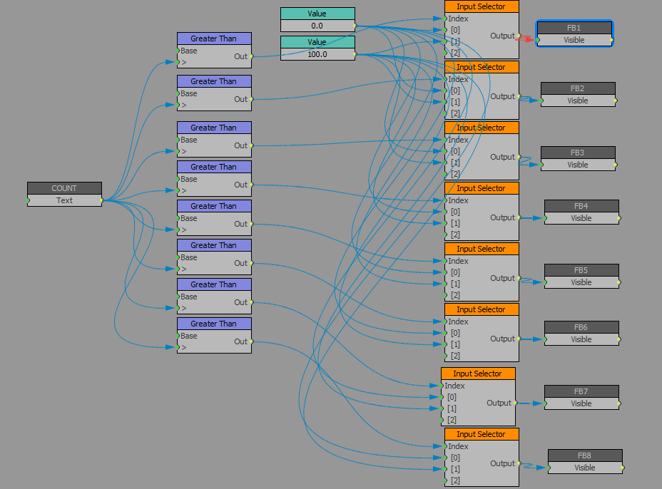

    give this a try. I'm sure there are better ways to do it, but this one gets it done. In the greater than block, I incremented the value by one on each one.
    Malcolm Thorpe
  • 8.  RE: How to link the Counter Widget to a quad?
    Posted 06-17-2023 15:42
    Hi Malcom,
    Thanks for your help! Great that you took time to make this for me.
    But i'm not getting it done. And I don't know where the problem is. Build everything what you send in the photo!
    Which value dit you put in the greather than block? And did you put the index offset to another value in the input selector? And is every 0,0 value put to the '0' and every 100 value put to the '1'?
    Nik Cramer
  • 9.  RE: How to link the Counter Widget to a quad?
    Posted 06-17-2023 15:48
    I didn't do any offset. The first value at the top is 0 zero. And it controls visibility of the first football. So if the counter is greater than zero, turn on the first football. Next block is 1. It controls the second football if the counter is greater than 1 turn on football 2. And so on.
  • 10.  RE: How to link the Counter Widget to a quad?
    Posted 06-17-2023 16:06
    It worked! Thanks a lot man.

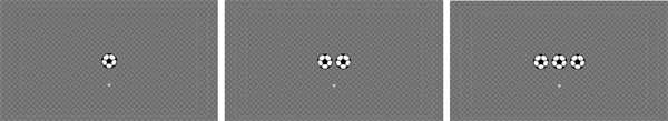

    And one last question; if i want this system but every football is centered like in the picture below. How would I fix that?
    Nik Cramer
  • 11.  RE: How to link the Counter Widget to a quad?
    Posted 06-17-2023 16:32
    A quick fix would be to lay out the balls in photoshop where they are positioned like you want. Then export them, numbered 1-8. Then apply those materials to the quads 1-8. But instead of using greater than, use the equals. So if the counter is “1” then then in football 1 and so on.

    May I ask why you have all the input options to choose between "0" and "100" per "FB" object? Visibility is a boolean (zero or one) function so the outcome of the the "Greater Than" block (being zero or one) is enough to set the visibility of the "FBx" objects in my opinion...
    Rob van Rooyen
    Senior Graphics Specialis
    NEP The Netherlands
    Hilversum Netherlands
  • 20.  RE: How to link the Counter Widget to a quad?
    Posted 06-18-2023 12:51
    a throwback to when I used to use an alpha value. But look, the world is still turning.
