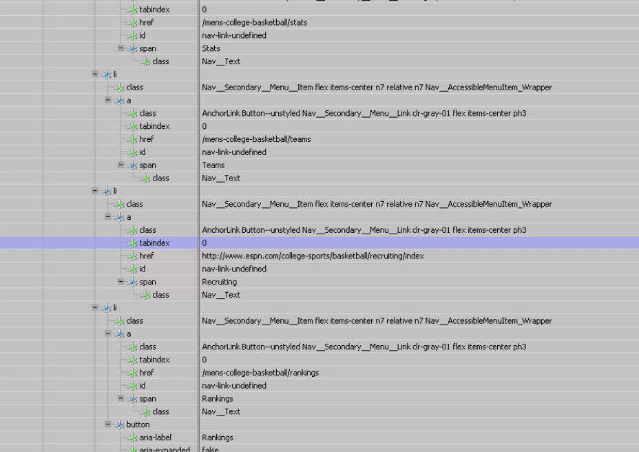

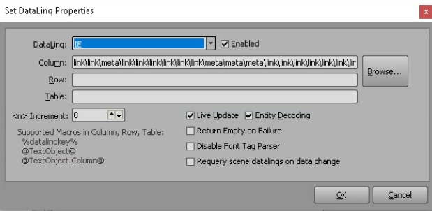

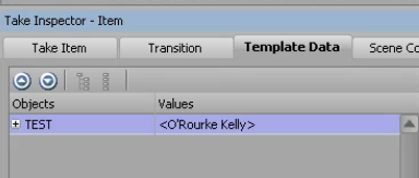

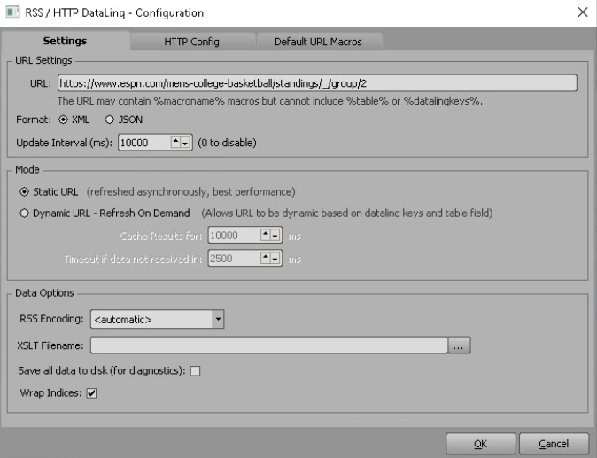

    I am trying to source data from a website via Datalinq in a scene. I am able to give the address to Datalinq, it successfully reads all the data, and I can view it in the Datalinq browse tab. If I try to set the data as a datasource in the scene, it will successfully display the value as text in the scene, but then cannot update until I manually reselect browse. If I publish the text object and try to datalinq it in the sequencer, it just reverts to the default texts in that object. Is there a reason I am unable to have values update as Datalinq refreshes?

    Just returns the default text from the text object, and leaves whatever the last successful datalinq was (in this image, Kelly was something pulled from an Excel file, which updates onscreen text successfully).
    The config in the scene.
    The datalinq config.
