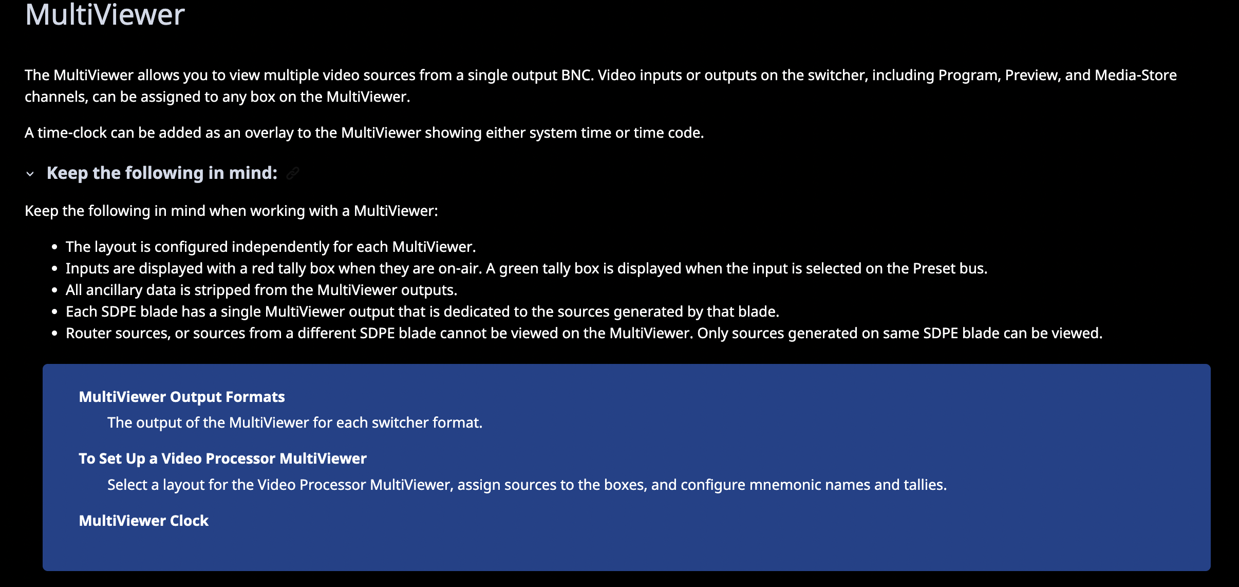

    Is it possible to add extrenal sources to the hypermax multiviewer?
    We can only add internal, media and ME follows to the boxes.

    The SDPE based MVs are only able to show what is coming into them on the Buses for the MEs, The internal Sources like Media and clip player and the "Outputs" that the ME generates PGMs/PVs/etc.
    The SDPE also Generate PiPs that feed the Ultriscape Multiviewers which can access All of the physical inputs, SDPE Generated PiPs.
    That is the section from the MV with more info and the link to follow that topic is here:
    https://help.rossvideo.com/hypermax/Topics/Setup/Video/MV.html
