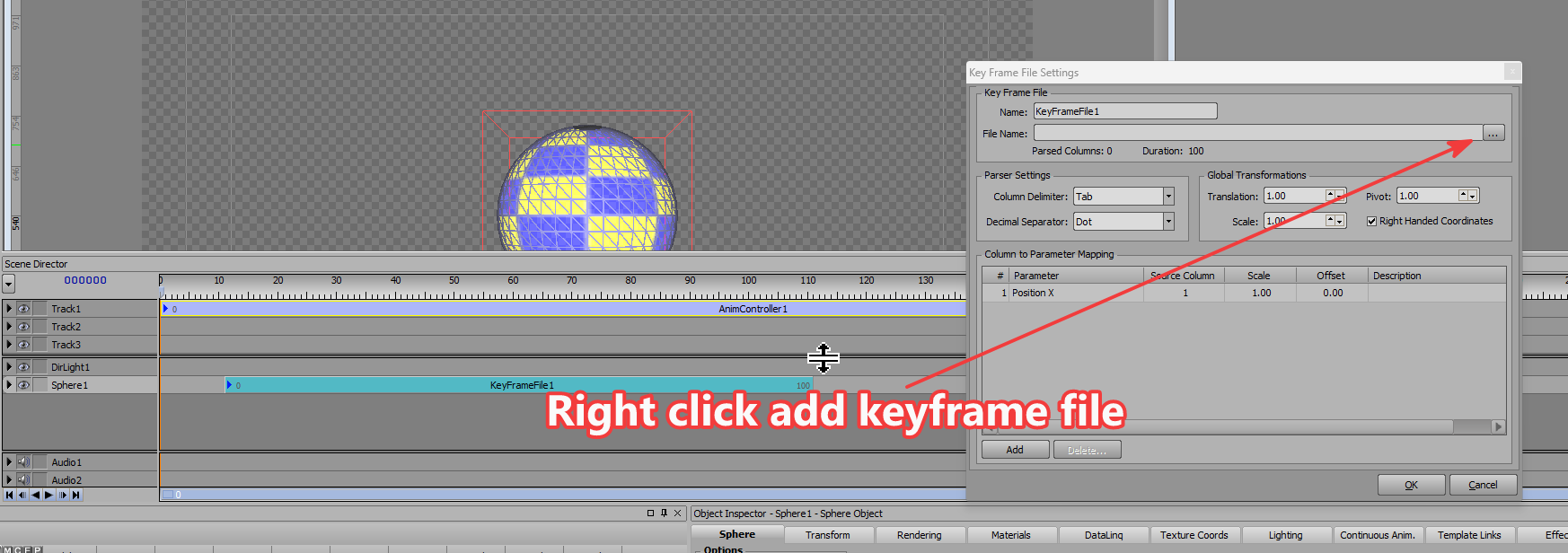

    You have to export an .mov (MOVE) camera file from Maya and then add it to the object track in the scene director

    Here is a sample MOVE file: XPression MOVE File Camera Keyframe.mov
