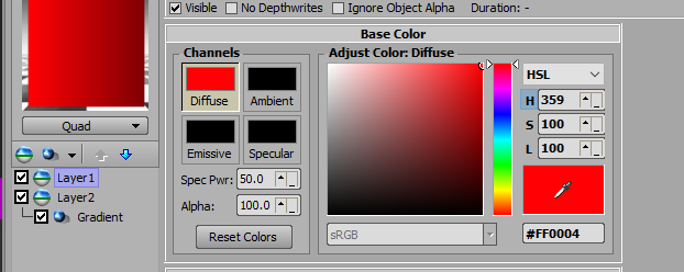

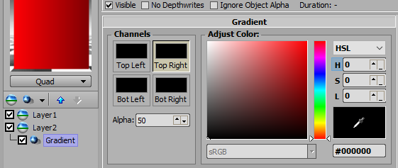

Depends what the gradient is but if its just light to dark you can put the gradient on it but just make it black but alpha 0 on the sides where you want the colour and then alpha to the level you want it in the others like 2 parts are alpha 0 and 2 are alpha 25 so it goes light to dark and then your diffuse is your colour behind that.

Unfortunately I need to change a gradient and that's no possible in Visual Logic.

I think you misunderstood me, you can adjust the material via script or visual logic. So you don't change the material you alter it.

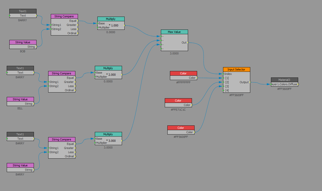

I usually go down the approach of changing the materials rather than the objects if that makes sense? So the material on the object never changes but you actually change the material itself.

This may be a version problem, I'm on Xpression 9.5
Imported a simple .obj file but I can not use Visual Logic to assign a material because it does not have the "Face" property available. Has this been added in newer versions?
Note: Already wrote this in VB, but our MOS plugin is version 11.There must be an API change because this works in the sequencer but not iNews. Second time this version difference has bitten me.
