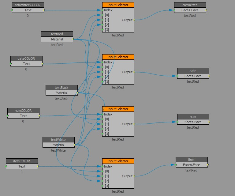

    Our team is new to Xpression and I'm trying to modify our existing workflow for the new system. I'm generating an XML to create a playlist which includes hidden Objects with dynamic materials names as well as visual basic text color changes tags. It appears as if the dynamic material and visual basic tag Objects are not read with the XML import unless the Objects are Published.
    Here is the text color visual basic I am using:
    Here is the Dynamic material path:
    Here are they layers:
    and here is a sample of the XML:

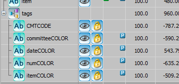

    If the CMTCODE, committeeCOLOR, dateCOLOR, numCOLOR, itemCOLOR Objects are Published, it works as expected. If the Objects are not published, the color and material do not update. I would like to keep the tags unpublished/not visible to the operators.

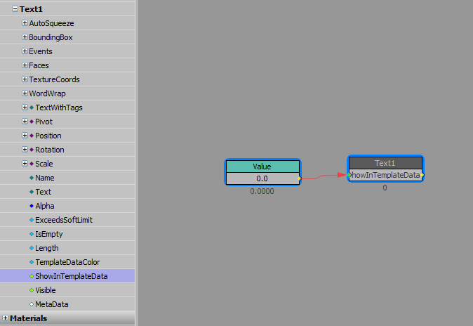

    They will need to be publish but you can hide them from user, you can script or use this method.

    Thank you Simon, that did it.
