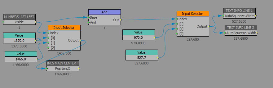

    Scenario 2: Column 1 is not visible and Column 2 shift on x-axis and increases on auto squeeze (visual logic attached)

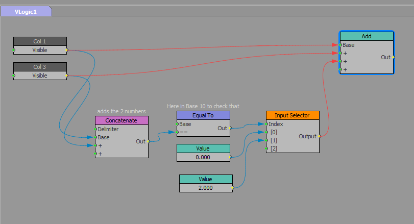

    you need 4 different states like - visible yes / visible no for col 1 or col 3:
    Col1 / Col 3 / Add
    Yes yes = 2
    No yes = 1
    No no = 0
    Yes no  = 1 = 10 = 3
    With a add you would get 3 states and need to make out of the yes no and no yes a seperate one. with that visual logic you get out off add the 0/1/2/3 - 4 different states that you can then use to do later the things you want.
    Regards Nicole

  • 4.  RE: INCREASE AUTO-SQUEEZE PER VISIBLE SCENARIOS
    Posted 03-15-2023 13:30
    Nicole -
    SUCCESS!!!!!!!!!!!!!!!!
    Thank you so much - maybe one day I'll understand what I just did.
