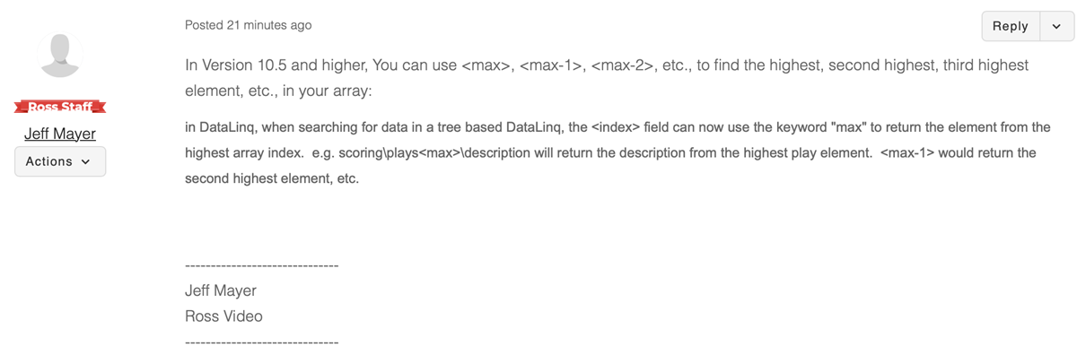

Hi John,
I can tell you how I'm doing it, but as you know, there is more than one way to skin a phoenix. First, I have a datalinq key in my scene named "idx". The value is set to max. This will ensure I pull the most recent drive data. I also use the datalinq key to pull the previous drive data, if needed. But I have found that I rarely, if ever, need to use it. Then on my text object for the stat, I am pulling
Column: drives/drive<%idx%>
Row: plays (or yards or top)
I have found that the drive column only shows up in the xml file when the game is live. If you're trying to use an xml file for a completed game, you won't see the drive column. I believe I had my SID run a test game to set up my Drive Summary.
I hope that helps.
