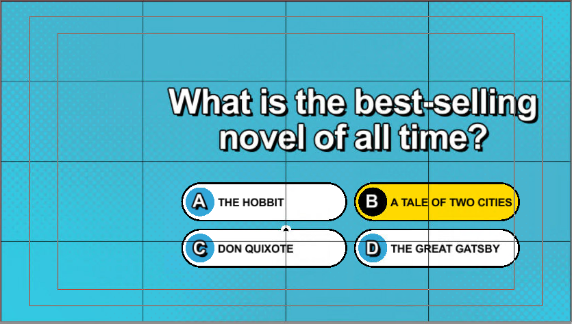

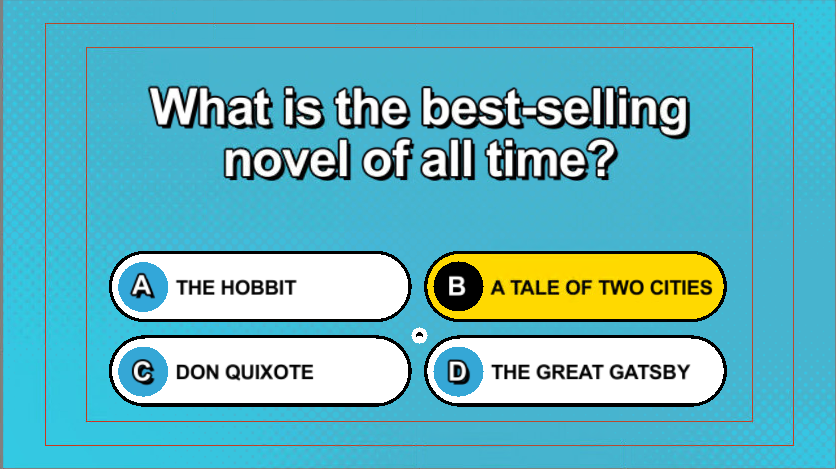

Sent: 05-01-2023 15:36
From: Adriana
Subject: Initiating certain triggers dependent on Quiz Answer
1) I have two templates that will have the same question and answers. Is the best way for everything to be the same info through an Excel sheet and datalinq? Or is there a way I can feed one's info to another template?
2) With that being said, by default, the colors are not highlighted unless someone chooses an answer, which I am guessing with whatever answer they choose, they will re-drop in the template anyway?
Am I overthinking I can create triggers for scene directors in the the one template depending on the answer they chose?
Or will it be easier to make other templates (with respective animation controllers and scene directors) to animate the correct answer?
Which then goes back to my first question, if I need to create 4 additional templates so they can drop whichever to display the correct answer, would datalinq be easy to have the same info across all the templates?
Adriana Dougherty
WEIGEL BROADCASTING COMPANY
