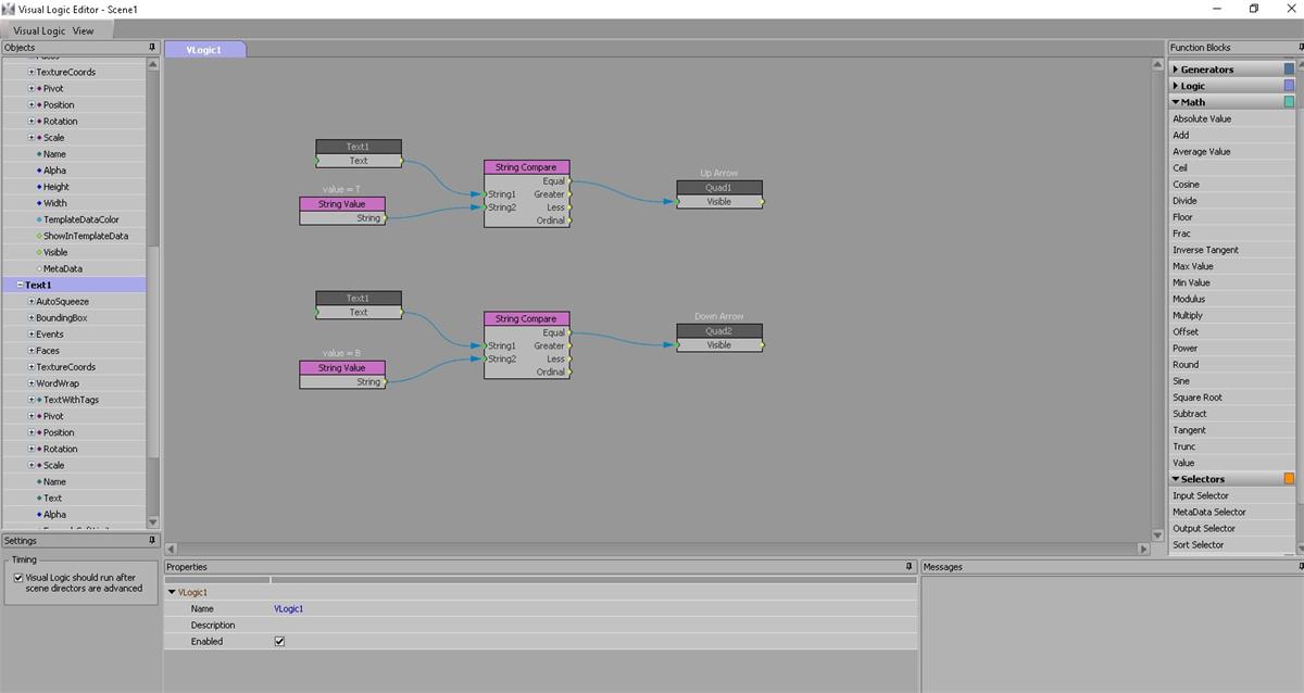

    *EDITTED
    If you prefer visual logic, then you can do this.  When you setup the graphic, make sure Text1 is set to your data source and everything is set to invisible. Best of luck.
