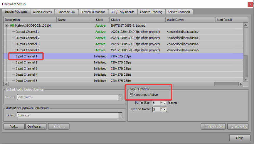

    Also check and see if you have the Keep Input Active option in the XPression hardware setup and enable it:

    Do have "Keep Input Active" selected (have tried it both ways with no appreciable change in behavior)
