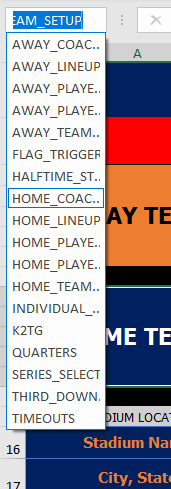

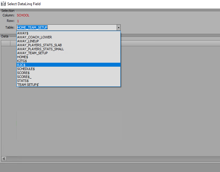

I have created tables. Not all of them are showing up as you can see in my screenshots posted above. All the Excel tables are listed but not all of them are in Xpression.
I think I found the issue - it had a hard time reading the Excel document that's linked to another Excel document. Which is unfortunate. I had a separate document where all the teams assets are (team names, team schools, Values for each R, G, B, and the logo location) as we are constantly updating as we grow our database. Once I added the Team Assets back into the same sheet, all my tables were available in Xpression.

When using excel with XPression always create tables and connect to them and not to the $sheets.
