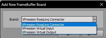

    I just wanted to confirm that Desktop Preview is not available in the XPression Trial?
    I'm rather confident that it isn't and I can understand the reasoning, although I just wanted to confirm.
    I  see the available FrameBuffers listed as the following:

    No Desktop Preview server in XPression Trial Edition.
    Trial Edition Limitations:
    • All Scenes loaded into or exported from XPression Trail will be watermarked permanently
    • Maximum 25 scenes per project
    • Maximum 50 take items in Sequencer
    • Maximum 2 Project Files loaded at a time
    • Commercial Project Files can be loaded, but will be limited to the first 25 scenes and 50 take items in the file
    • Only deployment from Project Server is supported, no publishing
    • Clip Server Database is supported
    • Datalinq is supported
    • RossTalk is supported
    • No support for: Tessera Region Mapping, CII, VDCP, AMP, MOS, API, Desktop Preview Server, Dashboard API
    • No exporting of: Transition Logic, Visual Logic or Sequencer Take Item Lists
