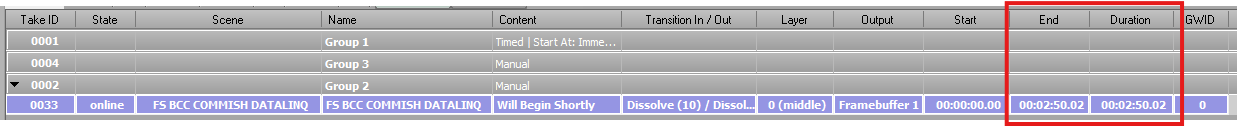

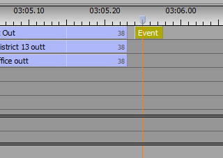

  • 8.  RE: Issue with playing a scene director
    Posted 07-21-2025 11:46
    Hi.
    Your takeitem duration is 00:02:50:02 and Scene Director stopped playback at 00:02:50:02 (5102 frames).
    The jump back event occurs at 00:03:05:24.
    Change the duration in the takeitem or add the following script to OnLine.
    Dim anim as xpSceneDirector
    Self.GetDefaultSceneDirector(anim)
    anim.PlayRange(0, 5600)
    Roman Yaroshenko
    chief specialist
    RBC-TV
    Moscow Russian Federation
