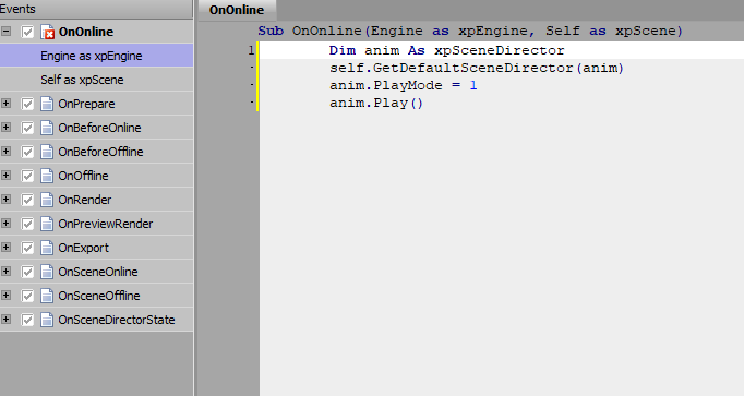

    I added that script to my project to check and i got this RED X on the online text. look at picture. Is it becuase i have an older version of xpression? we are running version 8.5 and your version is 10 or higher?  The project dissolves in but it does not play the slides. I'm thinking its because of the version. I got the message saying it was created in another version and some things might not work correctly.

    Hi Lazaro.
    After you have pasted the script, you need to press the F7 key. If there are any errors in the script, Xpression will write about it below.

    Posted 02-07-2025 14:28
    Thank you, Roman. Everything is working now. I had to change the scene director and set it to default. F7 gave me no errors, and everything is working as it should. Thanks again!
