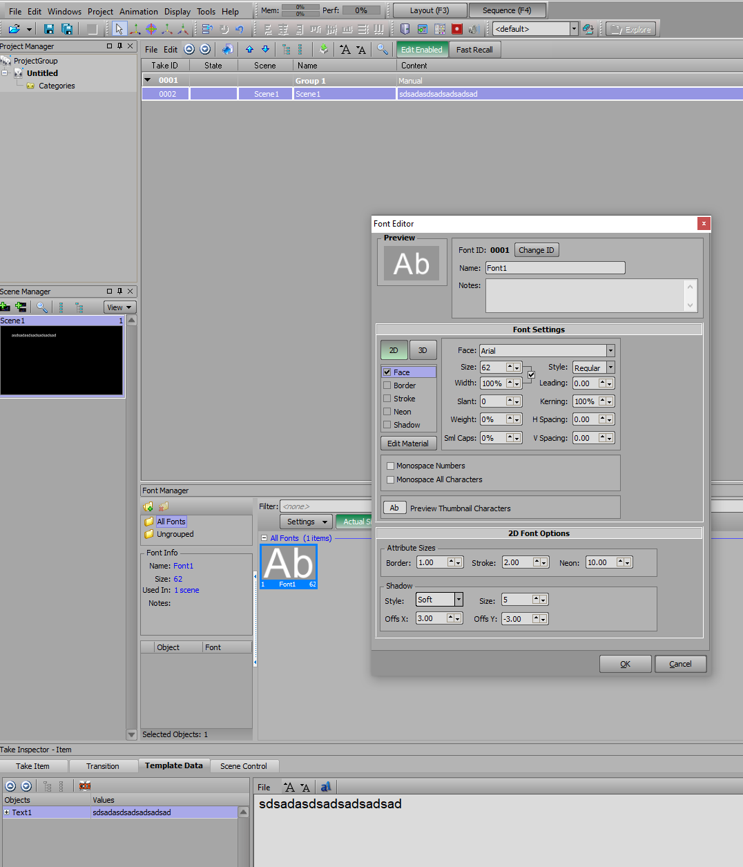

    I take that back actually, you can open the font manager which will allow you to get at the kerning without going to layout.
  • 14.  RE: Kerning in Sequencer
    Posted 07-04-2022 10:33
    Thanks Red, I have tried this and by changing the value percentage in the kerning box, makes no difference.
    I suspect if it did, it would probably change the 'kerning' to the whole typeface and not just the typography of the 'time' like you can in layout by placing your cursor in the correct postion and then CTRL + or -
    I guess this is something which needs to be provided in the next software release?
